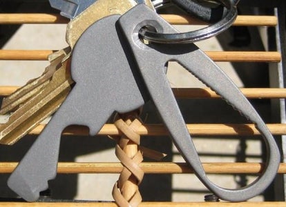

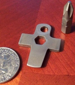

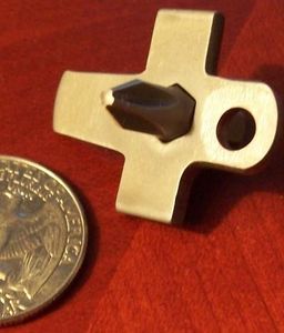

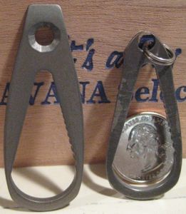

From the pocketwrench II purchased from Lee Valley, I was able to create two new modified tools. One I call the Skrench (Keychain Tool Pictured on the Right Below). This small keychain tool is able to not only turn nuts, but also screw and pry. The second one I call the Cruci-fix (3rd and 4th Picture), again able to screw and pry, but also able to hold a philips bit as shown.
I created the pieces using a High alloy hacksaw blade, drilled the piece using tungsten carbide drill bits, and used a motorized grinding wheel for stock removal. I finished both of the pieces off by using a Chicago brand tumbler with rocks and grit for 3-4 days.

Photo 2 - Skrench

Photo 3 - Cruci-fix

Photo 4 - Cruci-fix
