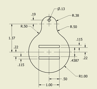

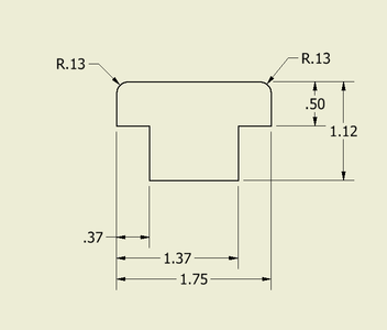

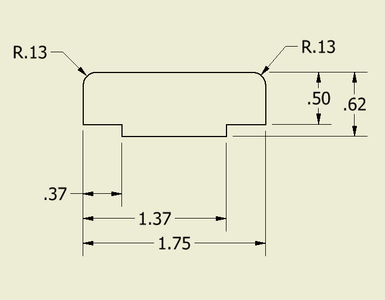

The first step is to get the files. You can use my drawings or you can make your own based on them. The product involves three pieces: the base, the large tab, and the small tab. If you want to make your own, my dimensions are shown above. Here are the dxf files for the pieces if you want to download mine (note: to get the files, right click on them and select "save link as" on Firefox and chrome or "save target as" on internet explorer. Once you have downloaded them, you can open them with a CAD program such as AutoCAD)

Put the pieces together simply by putting the tabs into the holes in the base and pushing them all the way though. Make sure the widest parts of each tab are on opposite sides of the base (i.e. one is on the bottom and the other is on the top. Also ensure that the large tab is in the slot furthest from the keychain hole; otherwise, it will not stand up properly. Once you have all the pieces together, make sure it works with your phone. If it does, just glue the pieces together with wood glue. If it doesn't, you can adjust the drawings and repeat the process. Do this until you are satisfied with the product.
