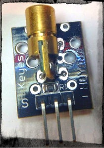

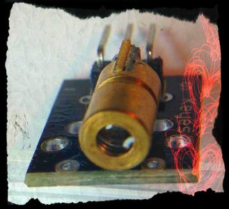

I picked up a Keyes KY-008 Laser Transmitter from ICStation. I just went to play with it and found out there's a lot of confusion out there about this particular module. The fact that it appears to be impossible to locate an actual datasheet or any kind of official specifications document for it doesn't help matters any. Neither does the fact that it appears the circuit board is mislabeled.

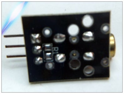

This module has three pins. Reference the second picture above and the pins are labeled (from left to right), pin1 = S, pin2 (center) = good question/not labeled, pin3 = - (minus sign).
From what I've been able to determine the pins should be labeled;
Pin1 = Vdc
Pin2 = Ref
Pin3 = GND
I found a lot of comments about Pin2 (the center pin) not being connected to anything. That may be true on different models or older models perhaps, but on mine Pin2 is outputting the exact same voltage that's coming into the module. Off the top of my head I can see two good uses for that type of output; 1. You could use it to monitor the incoming power supply and adjust it automatically based on the output voltage. 2. You could also monitor that pin and trip a warning or alarm when that pin drops to zero (as in someone cut the power supply) or when the voltage drops below an acceptable level for your application.
Long story short, this module works and provides an option to monitor the modules power supply.

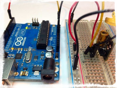

Wiring Setup: (not much to do here either)
(always remember to disconnect any and all power supplies prior to setting things up)
1. connect pin 2 from Arduino to Vdc (sorry, to "S") on the module
2. connect GND from Arduino to - on module
3. and optionally connect the modules center pin to A5 on your Arduino (one of the attached sketchs will output the voltage being monitored on the center pin of the module to Arduino's serial monitor)
That appears to be all we need to set this up. Could you hit that Next button again for me please...
