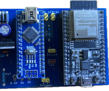

Solder the components to a perfboard, or get this board manufactured. To print the PCB, upload the entire zipped file to the "instant quote" part of jlcpcb. If you decide to use my PCB design, then you'll specifically need an esp32 devkit V4. The polarity of the optocoupler-keyfob connection needs to be correct. If you're not using exactly the same keyfob as me, then dismantle your keyfob, power it up, and measure the voltages on either side of the push buttons. My Bosch 880 alarm keyfob has a common +ve for all the push-buttons, but different keyfobs might be configured differently. After soldering the wires to the tiny exposed solder pads on the keyfob, I put some hot glue on the wires to protect the joins.
The buttons on my bosch880 keyfob have to be pressed down for slightly less than 1 second to trigger any action. That functionality is programmed into the Arduino code (below). Install the very awesome HomeSpan library in Arduino via tools -> manage libraries -> search for HomeSpan. I installed HomeSpan v2.0.0 using Arduino V2.3.3 with the Espressif board manager V3.0.7. If you use the same versions that I did, then you’ll need to change the partition scheme in order to fit the firmware onto the flash memory. Under tools, change the partition scheme to Minimal SPIFFS (1.9MB APP), and then upload either the code below, or use this latest code.
