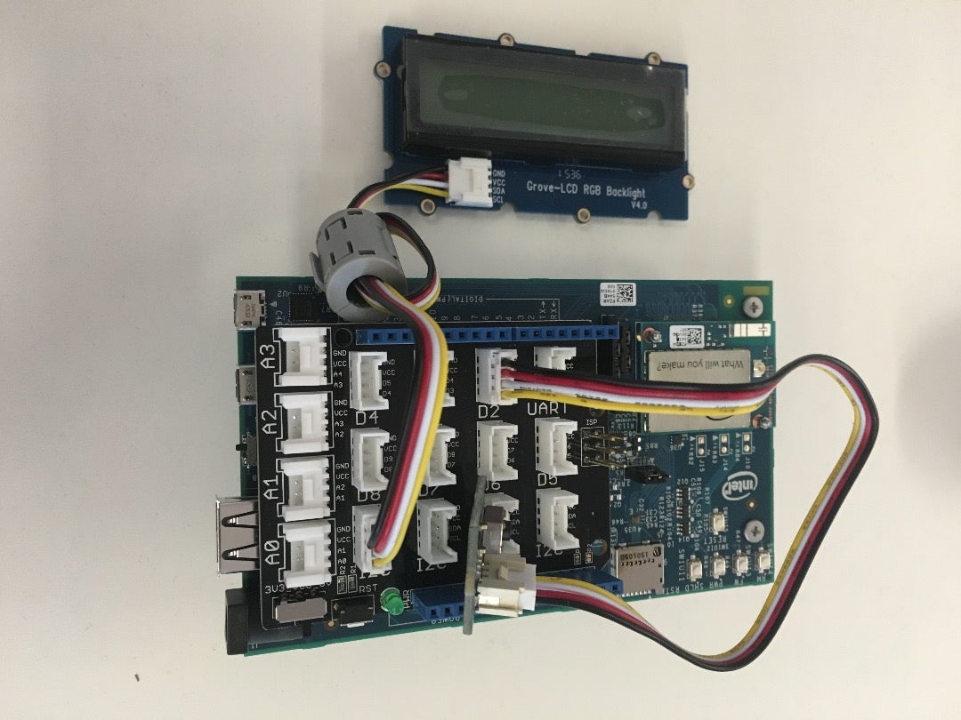

Step 1: Step 1: Assemble Edision Card
Assemble the Edision card, mounting the chip and its Base Shield
Step 2: Step 2: LCD and Button
Add to the shield, the LCD screen and the button, configuring it as photos.

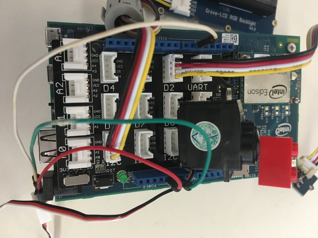

Step 3: Step 3: Add Servo
Add to the shield, the actuator, configuring it as photos.

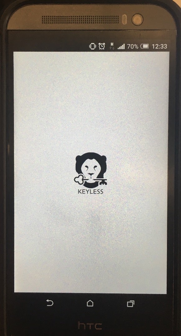

Step 6: Step 6: Install APP on Mobile
You have to import and run Android App.
https://github.com/stefanosalvucci/hackathon-keyless-mobile
