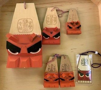

A 神社 (Shinto shrine) is a religious facility based on the beliefs of 神道 (Shinto), a religion unique to Japan. Each shrine has its own amulet, and one of those shrines, the 鎌倉宮 (Kamakura-gū) amulet, was in my house.

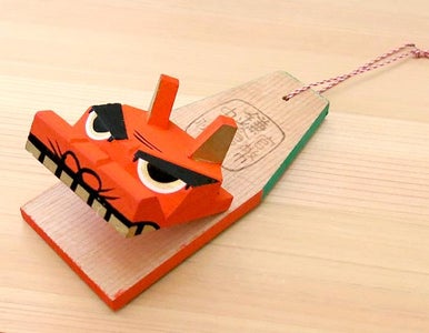

One day, I was looking around the room, wondering if there was anything interesting.🤔 Since I started making my own keyboards, various things have come to look like keyboards. It's some kind of sickness. "Huh? The nose part of this amulet looks like a keycap?"😅
That is the 獅子頭 (Lion head) amulet, which is the motif of this time.
*獅子頭 (Lion head) refers to the head of a 獅子舞 (Lion dance). 獅子舞 (Lion dance) is one of the traditional performing arts seen in East Asia and Southeast Asia, in which 獅子 (Komainu) dance to the 祭囃子 (accompaniment of festival music).
