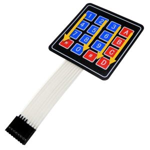

  • Keypad

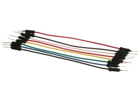

  • Jumper wires

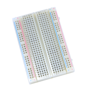

  • Breadboard

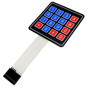

  • Connect Keypad pin 1 to Arduino digital pin 2
  • Connect Keypad pin 2 to Arduino digital pin 3
  • Connect Keypad pin 3 to Arduino digital pin 4
  • Connect Keypad pin 4 to Arduino digital pin 5
  • Connect Keypad pin 5 to Arduino digital pin 6
  • Connect Keypad pin 6 to Arduino digital pin 7
  • Connect Keypad pin 7 to Arduino digital pin 8
  • Connect Keypad pin 8 to Arduino digital pin 9

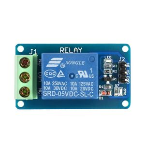

To Add a Relay and a solenoid:
  • Connect Relay VCC pin(+) to Arduino 5V pin
  • Connect Relay GND pin(-) to Arduino GND pin or to breadboard pin GND Line
  • Connect Relay signal pin(S) to Arduino Digital pin 11
  • Connect power supply 12V (+) to solenoid red wire(+)
  • Connect power supply 12V (-) to solenoid pin(com)
  • Connect solenoid black wire (-) to relay pin(NO)

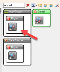

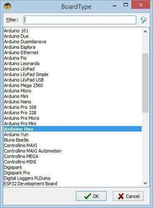

Step 4: Start Visuino, and Select the Arduino UNO Board Type
Start Visuino as shown in the first picture Click on the "Tools" button on the Arduino component (Picture 1) in Visuino When the dialog appears, select "Arduino UNO" as shown on Picture 2

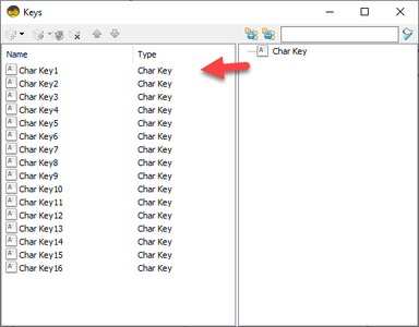

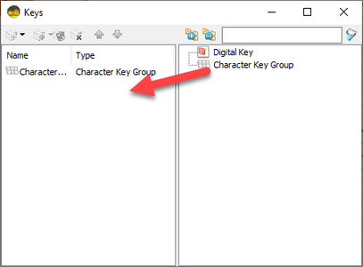

  • Double click on the "Keypad1" and in the "Keys" window drag "Character Key Group" to the left side, in the properties window select "Keys" and click on the 3 dot button, now in a "Keys" window Drag 16X "Char Key" to the Left side, and for each key set "Character" in the properties window set "Character" for each in the order like you see on picture 6, for
  • "Char Key1" the "Character" will be 1
  • for "Char Key2" the "Character" will be 4
  • for "Char Key3" the "Character" will be 7
  • for "Char Key4" the "Character" will be *
  • for "Char Key5" the "Character" will be 2
  • and so on until the end

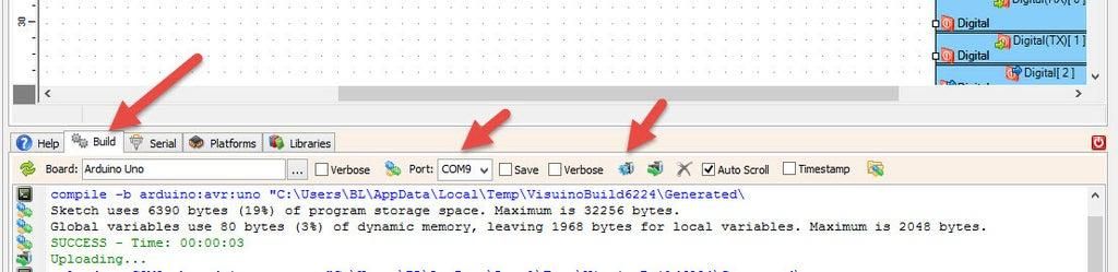

Step 8: Generate, Compile, and Upload the Arduino Code
In Visuino, at the bottom click on the "Build" Tab, make sure the correct port is selected, then click on the "Compile/Build and Upload" button.
