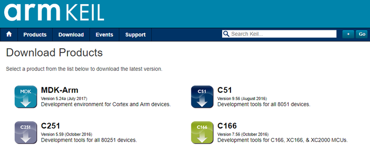

1 Keil uvision: Their are lots of product from keil. so you will be required c51 compiler. You can download that software from here

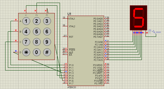

Step 3: Circuit Diagram:
Step 4: Code and Video
The whole Project Description is given in above video
You can get the source code from our GitHub Link
If you have any doubt regarding this project feel free to comment us below. And if you want to learn more about embedded system you can visit our youtube channel
