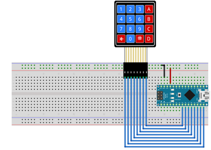

Step 2: Keypad Wiring
Connect the Keypad as following:
Arduino >> Keypad
D5 >> 1
D6 >> 2
D7 >> 3
D8 >> 4
D9 >> 5
D10 >> 6
D11 >> 7
D12 >> 8

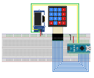

Step 3: OLED Wiring
Connect the OLED as following:
Arduino >> OLED
GND >> GND
5V >> VCC
A4 >> SDA
A5 >> SCL

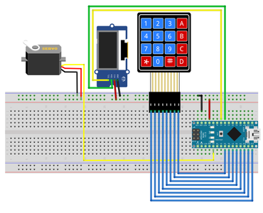

Step 4: Servo Wiring
Connect the Servo as following:
Arduino >> Servo
GND >> GND
5V >> VCC
D2 >> Signal

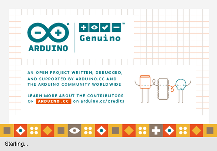

Step 6: Uploading the Program
Open the program on Arduino IDE. Once it is open, compile the sketch to see if it is clear of error then you can upload it. Make sure you have all the libraries download before you upload the program. After you have uploaded the program you should see the screen turn on and display "Keypad Smart Door Lock."
