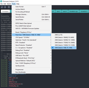

Step 9: Change the "Flash Size" to the "2MB (Sketch: 1MB, FS: 1MB)"
KhadashPay needs memory allocated for the file system to function.
To allocate the memory for the file system, click "Tools" -> "Flash Size" -> "2MB (Sketch: 1MB, FS: 1MB)"

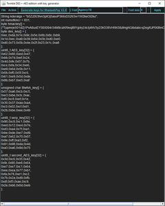

Step 11: Generate Keys
To make the unauthorized deciphering of your data computationally infeasible - It is crucial to generate your own keys and never reuse them
It's entirely up to you how to generate the keys. I can only offer you an option to do so.
I've modified one of my previous projects to work as a random number generator, the generated output seems "random enough" for me, but I haven't run any tests. So, I can't guarantee that it's random.
Use it at your own risk!
To generate the keys - launch gen.exe from the "V2.0\Raspberry_Pi_Pico_Version\Untested RNG" folder and click the "Generate keys for KhadashPay V2.0" button. The background turns from dark gray to light gray when you press that button.

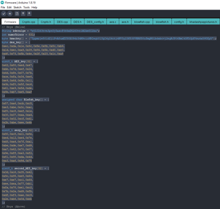

Step 12: Modify the Firmware
Open the "Firmware.ino" file from the "V2.0\Raspberry_Pi_Pico_Version\Firmware" folder and replace my keys with those you've generated.

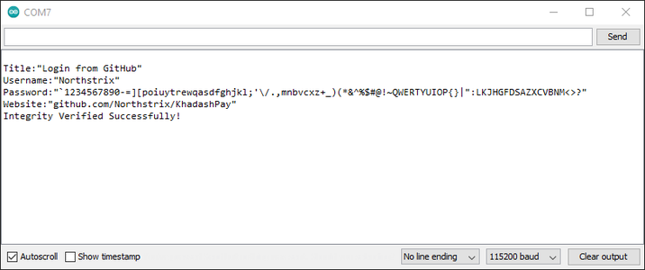

Step 22: View Login
To view a login:
  1. Select the "Other Options" line in the main menu;
  2. Press "Enter" on the PS/2 keyboard;
  3. Tap the operator RFID card on the RFID reader;
  4. Select the "Logins" line;
  5. Press "Enter" on the PS/2 keyboard;
  6. Select the "View" line;
  7. Press "Enter" on the PS/2 keyboard;
  8. Choose the slot from which you want to view the login by pressing the "←" (Leftwards Arrow) and "→" (Rightwards Arrow) keys on the PS/2 keyboard;
  9. Press "Enter" on the PS/2 keyboard;
  10. Press the "Tab" key on the PS/2 keyboard to print the record to the serial terminal.
