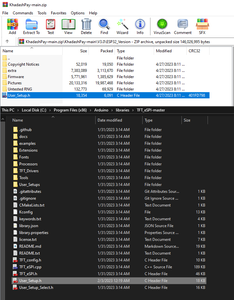

Step 8: Replace the Preset File for the TFT_eSPI Library
TFT_eSPI Library requires the config to be adjusted depending on the display and the board that drives that display. Initially, I wanted to write the mini-guide on adjusting the config for the ILI9341 display to be properly used on the ESP32's HSPI. But then I realized that it would be more convenient to attach the adjusted config to the firmware and tell you where to place it.
Take the "User_Setup.h" file from the "V3.0\ESP32_Version" folder and place it in the "C:\Program Files (x86)\Arduino\libraries\TFT_eSPI-master" folder.

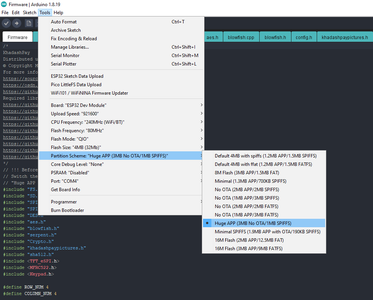

Step 9: Switch the Partition Scheme to the "Huge APP (3MB No OTA/1MB SPIFFS)"
You have to switch the partition scheme to the "Huge APP (3MB No OTA/1MB SPIFFS)" before you continue working with ESP32 because the firmware for the vault is too big for the default partition.

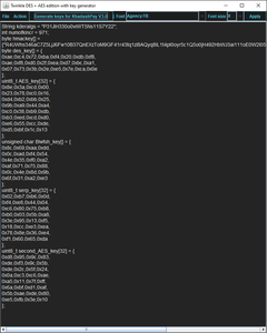

Step 10: Generate Keys
To make the unauthorized deciphering of your data computationally infeasible - It is crucial to generate your own keys and never reuse them
It's entirely up to you how to generate the keys. I can only offer you an option to do so.
I've modified one of my previous projects to work as a random number generator, the generated output seems "random enough" for me, but I haven't run any tests. So, I can't guarantee that it's random.
Use it at your own risk!
To generate the keys - launch gen.exe from the "V3.0\ESP32_Version\Untested RNG" folder and click the "Generate keys for KhadashPay V3.0" button. The background turns from dark gray to light gray when you press that button.
