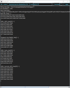

Step 7: Generate Keys
To make the unauthorized deciphering of your data computationally infeasible - It is crucial to generate your own keys and never reuse them
It's entirely up to you how to generate the keys. I can only offer you an option to do so.
I've modified one of my previous projects to work as a random number generator, the generated output seems "random enough" for me, but I haven't run any tests. So, I can't guarantee that it's random.
Use it at your own risk!
To generate the keys - launch gen.exe from the "V3.0\STM32F401CCU6_Version\Untested RNG" folder and click the "Generate keys for KhadashPay V3.0" button. The background turns from dark gray to light gray when you press that button.

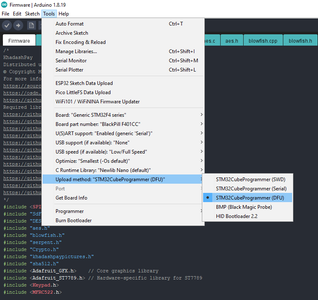

Step 9: Flash STM32F401CCU6
Set the STM32 Black Pill into the bootloader mode by doing the following:
  • Hold the BOOT0 button;
  • Press the NRST button;
  • Release the BOOT0 button.
Make sure that the settings in the "Tools" tab match those on the screen, especially the following settings:
Board: "Generic STM32F4 series"
Board part number: "BlackPill F401CC"
U(S)ART support: "Enabled (generic 'Serial')"
Upload method: "STM32CubeProgrammer (DFU)"
And then, upload the firmware from the "V3.0\STM32F401CCU6_Version\Firmware" folder into the STM32.
You don't need to select the COM port to flash STM32 Black Pill.

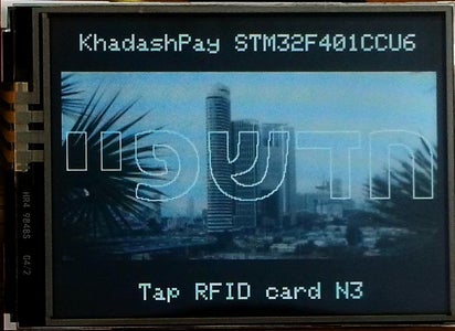

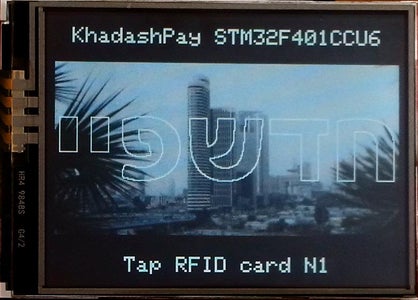

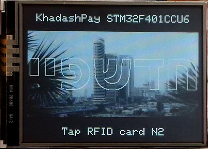

Step 11: Power the KhadashPay Up and Tap Four RFID Cards on the RFID Reader
After being powered up, the KhadashPay displays the "KhadashPay STM32F401CCU6" and "Tap RFID card N1" inscriptions alongside the lock screen.
Tap four RFID cards on the RFID reader one after another. The most important thing here is to tap the cards in the same order every time you unlock the KhadashPay. Otherwise, it just won't unlock.
If you don't have four cards, you can tap one card four times.
And by the way, the first card you tap on the RFID reader becomes the "operator card" right after you set the master password. You'll need this information later in this tutorial. For now, just remember it.

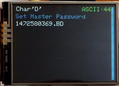

Step 12: Set the Master Password
To use the KhadashPay, you first need to set the master password.
While entering the master password on the 4x4 keypad, note that the '*' key serves as a backspace, and the 'A' key serves as a decimal point.
And remember, you can't change the master password without losing the ability to decrypt all user data stored on the SD card!
KhadashPay won't be able to decrypt the user data without the master password because the keys for the encryption algorithms are partially derived from it. Perhaps, it won't even unlock without the correct master password.
When you're done entering the master password, press either the '#" or 'C' key on the keypad to finish the input and set the master password.

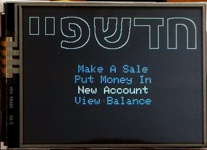

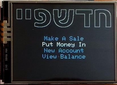

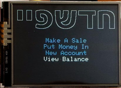

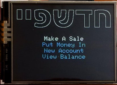

After you've unlocked the KhadashPay and got to the menu:
  • Press the "0" key on the 4x4 keypad to go down the menu;
  • Press the "8" key on the 4x4 keypad to go up the menu;
  • Press the "#" key on the 4x4 keypad to perform the selected action;
  • Press the 'D' key on the 4x4 keypad to show the lock screen. After that, press any key to return to the menu.

To create an account on KhadashPay V3.0:
Operator:
  • Select the "New Account" line in the menu;
  • Press the '#' key on the 4x4 keypad;
  • Tap the operator RFID card on the RFID reader;
  • Press the '#' key on the 4x4 keypad and give the device to the client.

Step 14: Put Money Into the Account
To put money into the account:
Operator:
  • Select the "Put Money In" line in the menu;
  • Enter the amount of money to be put into the client's account;

Step 15: Make a Sale
To make a sale:
Operator:
  • Select the "Make A Sale" line in the menu;
