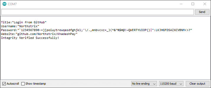

Step 3: Integrity Verification
Another cool feature provided to you by KhadashPay is the "HMAC-SHA256"-based integrity verification.
Before encrypting the user data, KhadashPay computes the tag for that data and encrypts it alongside data.
Later on, when KhadashPay decrypts your data, it also decrypts the previously calculated tag and computes a new tag for the newly decrypted data. It then compares both tags. If they don't match - KhadashPay will promptly notify you that the integrity verification has failed.

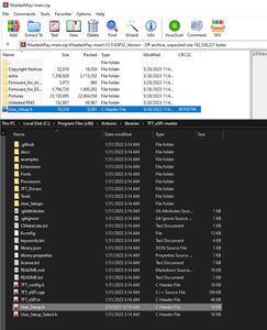

Step 8: Replace the Preset File for the TFT_eSPI Library
TFT_eSPI Library requires the config to be adjusted depending on the display and the board that drives that display. Initially, I wanted to write the mini-guide on adjusting the config for the ILI9341 display to be properly used on the ESP32's HSPI. But then I realized that it would be more convenient to attach the adjusted config to the firmware and tell you where to place it.
Take the "User_Setup.h" file from the "V3.5\ESP32_Version" folder and place it in the "C:\Program Files (x86)\Arduino\libraries\TFT_eSPI-master" folder.

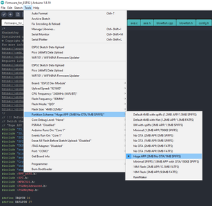

Step 9: Switch the Partition Scheme to the "Huge APP (3MB No OTA/1MB SPIFFS)"
You have to switch the partition scheme to the "Huge APP (3MB No OTA/1MB SPIFFS)" before you continue working with ESP32 because the firmware for the vault is too big for the default partition.

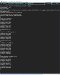

Step 10: Generate Keys
To make the unauthorized deciphering of your data computationally infeasible - It is crucial to generate your own keys and never reuse them
It's entirely up to you how to generate the keys. I can only offer you an option to do so.
I've modified one of my previous projects to work as a random number generator, the generated output seems "random enough" for me, but I haven't run any tests. So, I can't guarantee that it's random.
Use it at your own risk!
To generate the keys - launch gen.exe from the "V3.5\ESP32_Version\Untested RNG" folder and click the "Generate keys for KhadashPay V3.5" button. The background turns from dark gray to light gray when you press that button.

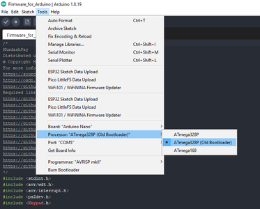

Step 13: Flash Arduino
Upload the firmware from the "V3.5\ESP32_Version\Firmware_for_Arduino" folder into the Arduino.

Step 22: Connect PS/2 Keyboard to KhadashPay
After exploring the payment system capabilities of the KhadashPay V3.5, it's time for you to explore the vault capabilities.
Connect a PS/2 keyboard for a better user experience.
Step 23: Add Login
To add a login using the PS/2 keyboard:
  1. Select the "Other Options" line in the main menu;
  2. Press "Enter" on the PS/2 keyboard;
  3. Tap the operator RFID card on the RFID reader;
  4. Select the "Logins" line;
  5. Press "Enter" on the PS/2 keyboard;
  6. Select the "Add" line;
  7. Press "Enter" on the PS/2 keyboard;
  8. Choose the slot into which you want to put the login to by pressing the "←" (Leftwards Arrow) and "→" (Rightwards Arrow) keys on the PS/2 keyboard;
  9. Press "Enter" on the PS/2 keyboard;
  10. Select the "PS/2 Keyboard" line;
  11. Press "Enter" on the PS/2 keyboard;
  12. Enter the title;
  13. Press "Enter" on the PS/2 keyboard;
  14. Enter the username;
  15. Press "Enter" on the PS/2 keyboard;
  16. Enter the password;
  17. Press "Enter" on the PS/2 keyboard;
  18. Enter the website;
  19. Press "Enter" on the PS/2 keyboard.
