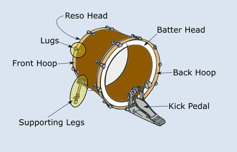

Step 1: Disassemble Drum
To start you will need to remove both the front and back hoops.
This can be done buy either loosening or completely removing the lugs. I chose to remove the lugs to reduce the risk of damaging or bending them. Beware if you remove them that they are in 3 parts and easy to lose.
If your drum still has the reso head and batter head on the can be thrown away or saved for another project.
My drum didn't have the legs but if it did i would remove those as well whilst leaving the hardware for them attached to the drum.
