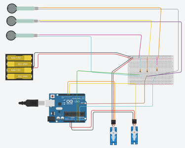

A second prototype was built by taping the MG996R to some spare wood and the SG90 to a smaller wood piece. I connected the battery pack to the breadboard and let both motors and the sensors draw power from it. As I will see later, this drained the batteries very quickly and led me to make the SG90 draw power from the Arduino itself, so that the batteries will be used for the MG996R (which needs the most power) and the sensors (which are almost negligible compared to the servo). I tested the angles for both motors, the ideal arm length and positions for reaching the object on the sensors no matter the exact placement and input sensitivity, which I only did on one of the sensors in this phase, due to efficiency reasons. After getting it right, I made the code for the one sensor into a function and called it for all three of them.

Step 8: Soldering
After being pleased with how everything functions, I went ahead and soldered everything together following the illustration you can see in the picture.
