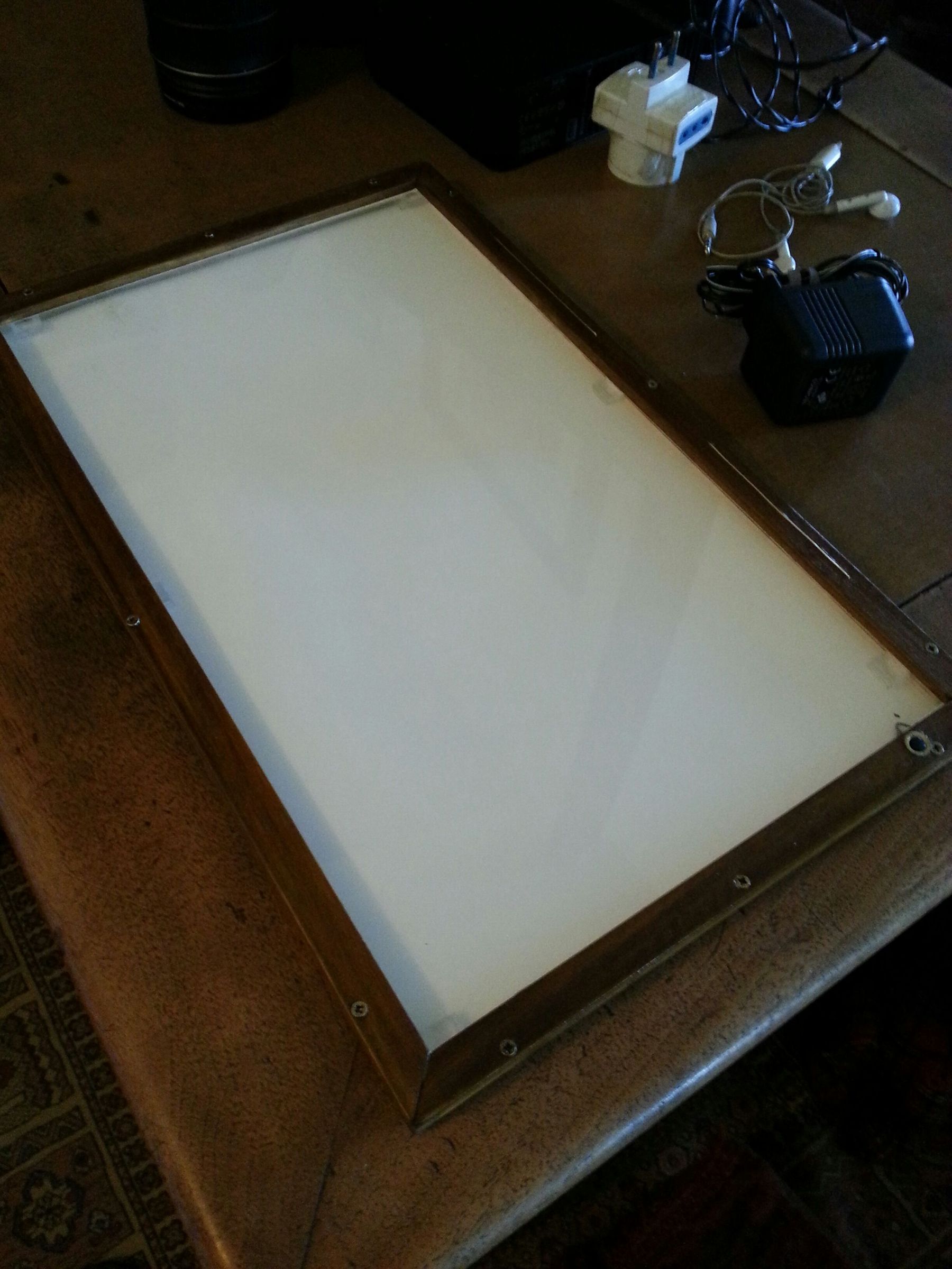

The windscreen is built with 3 layers of plywood with plexiglas inside.
