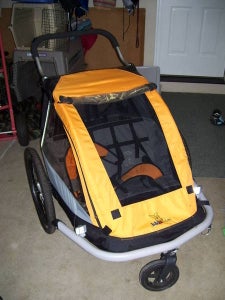

When my kids were young, we purchased a two-seater bike trailer from Costco that could double as a stroller. That thing followed my bike everywhere. But, as is the nature of children, they grew up. They learned to ride their own bikes and the trailer was banished to the storage shed where it has stayed for the past four years.
While cleaning out the shed recently , we rediscovered the trailer and decided to refurbish it into something a bit more appropriate for my now-older children. Because we often ride our bikes to go shopping, the most logical solution was to transform it into a cargo trailer.
