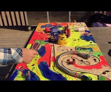

Dream AcadeME is a non profit alternative education organization. Our philosophy focuses on child-centered learning connected with STEAM (Science, Technology, Engineering, Arts, and Math), nature, and social-constructivism, an approach where children create their learning in a social dynamic. The Infinity Mirror is one of many project-based lessons we here at Dream AcadeME have lead, that integrates STEAM in a hands-on capacity, empowering our young innovators to build the world they dream possible! Check out another project our students worked on in woodworking class: https://www.instructables.com/id/Kids-Make-an-Adventure-Board/
