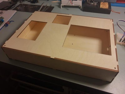

I used FreeCAD's Part Design and Sketcher workbenches to design the casing. First, a Body has to be created for any given piece of the casing. Here, casing is built using nine parts (Bodies, in FreeCAD's lingo):
  • front panel
  • back panel
  • four walls
  • three component panels
In FreeCAD part design starts with a sketch. Each panel is being drawn as viewed from top, with all edges, cutouts, and screw/mounting holes, and then extruded along an axis. This operation creates a solid body as the software takes an input sketch and "raises" it by specified distance - 3 mm in this case.
Once all panels are created, they can be moved around using FreeCADs "Transform" operation, which allows for moving the part along each axis and rotating it as needed. All done in 3D, so this is great for seeing how the parts would fit together.

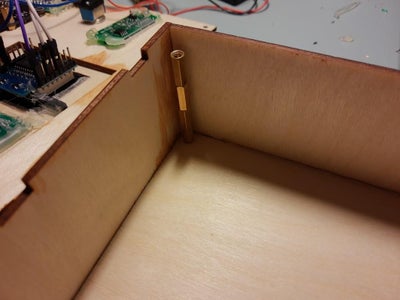

Somewhere between drawing a rough concept and buying wood to cut the casing I realized that it would make more sense to have all the panels cut out on a laser cutter. This way I could save some time in the build and achieve quality well beyond my reach, given my set of skills and tolls for woodworking.
So I added small notches on each panel, 10mm x 3mm, so that each panel can be snapped together and held mostly by friction. I also received great advice from the company which did the laser cutout: laser cutter's precision is ±0.5 mm, so if the notches are supposed to hold the casing together, notches have to be slightly bigger. For that reason actual notch is 10.4mm x 3mm, as seen on the drawing. Adding extra 0.2 mm on either side helps to mitigate a worst case scenario, in which laser cutter would be 0.5 mm off and make the cutout at 9.5 instead of 10mm. Also extra 0.2mm on each side makes for a tighter fit.
Since this is a kid's toy it shouldn't rely only on glue and friction to be held together. For that reason four screw holes are added in corners of front and back panel. Idea is to use 50mm distance screws to squeeze entire device together.
One of the side panels has a square cutout for DC barrel socket. Turned out that I only could get round barrel sockets, so it would've been better if the cutout was round. Still few seconds with a 10mm drill did the trick.
Back panel has four mounting holes in Arduino's Uno layout, for easy assembly.
Some remarks in hindsight, stuff I would've done differently now:
  • front panel should also have cutouts for battery level indicator and lever switches. I added those components late, so had to do the cutting manually. While lever switches are easy - just a 5mm hole, I did some damage to the panel when cutting out hole for the battery level indicator
  • second set of Arduino mounting holes would be nice. I thought that a second Arduino - connected to the LCD TFT shield - would just hang underneath the panel, plugged in with the LCD shield. Sadly, it didn't fit.
  • cutouts for USB ports (or at least place to expose Arduino's serial ports as pins) would be super useful.
  • placement of component panels could be improved. Actually, I should've grabbed 3D models of all the components to see how they fit together. That would've saved me some trouble during assembly.
  • notches on the walls are not symmetrical. Painting and assembly would be bit easier if they were.

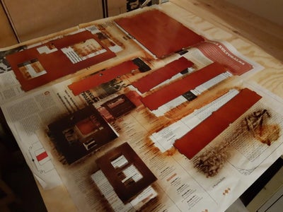

I used nitrocellulose hard paint for the panels, mostly because I had a couple of cans lying around. Any type of coating would do (actually, I had to cover one of the panels with carbon foil, because it turned out I painted it on the wrong side...).

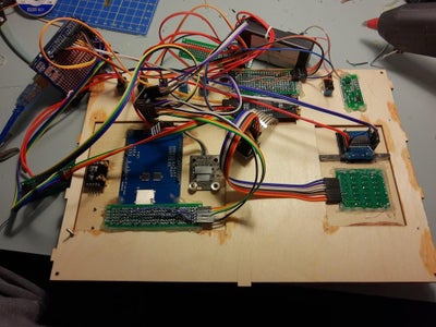

Now that the casing, and constraints it poses on the entire device, are more or less finalized, it's time to connect all the wires.
Since this project relies heavily on I2C interface, it makes sense to start with it. On Arduino Uno I2C pins are routed to both separate pins and to A4/A5 outputs. I suggest using the separate pins - P3.1 and P3.2 on the schematic. All the I2C devices have to be powered as well, so total of four lines (SCL, SDA , +5V, and GND) should be connected to the I2C breakout board (or the breadboard). These lines should go to both GPIO expander modules (let's call them GPIO_A and GPIO_B for easier reference) and an ADC module.
Both GPIO expander modules need to have their reset and addressing pins connected. Reset is an active low pin, so it has to be connected to +5V (ideally through a resistor). Address pins have to be set up so that both devices can operate on the I2C under different addresses - i.e. can be distinguished from one another. I've set up address pins on GPIO_A to zero (all connected to ground), and on GPIO_B to one (A0 connected to +5V, rest to ground). These settings translate to I2C addresses 0x20 and 0x21, respectively. Default address for ADC module is 0x48, so no conflicts here.
Rotary encoder pins A and B have to be connected to Arduino Uno pins 2 and 3. These are the only two pins with interrupt capability, and using interrupts rather that repeatedly ask for value update creates a much smoother user experience.
RGB LED module needs to be connected to PWM-capable pins (marked with a '~' sign on the Arduino board). PWM capability allows for brightness adjustments.
7-segment display power, LED matrix power, and the second Arduino (Arduino B, as called on the schematic; ones that drives TFT LCD screen) are connected through switches.
There are also two momentary lever switches (the ON-ON ones). One is used to enable battery level display LED, the other is wired to the ground to serve as a reset for Arduino A.
The custom four-color LED bar is using 3mm color LEDs, all connected to separate pins on Arduino using 220R series resistors to limit the current draw. A higher value can be used to dim the LEDs a bit.
Since the CAD drawing was more of a rough idea than a detailed design, I had to resort to using huge amounts of hot glue. It looks rather nasty but it keeps things in place; and since its on the inside of the casing, then who cares, right...?
Most of the components are glued and/or screwed to the front panel (or the top, depends on how to look at it). Both Arduinos and stuff related to power delivery (battery cells, battery protection circuit board, power breakout board) are mounted inside the casing. RGB LED module is also mounted (glued, in my case) inside, right beneath the 4x4 keypad module. There's roughly a 2cm distance between the keypad's PCB and the LED itself, so the RGB LED lights up entire board, which creates a rather cool effect.
Second Arduino Uno - Arduino B - is connected only to the LCD TFT shield. I couldn't fit it when connected directly to the display shield, so I had to use wires instead. Note that all eight data lines, all SPI interface pins, and +5V and +3.3V have to be connected.
