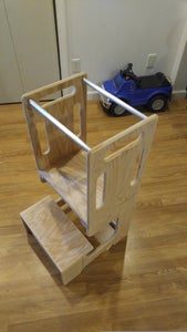

I was recently asked to build a "learning tower". For those who don't know what it is, its a step stool of sorts that allows a Toddler (or small child) to safely engage with activities on a counter or table. Its a great way for them to get involved in cooking and similar tasks. After extensive research I couldn't quite find anything that really spoke to me. So I decided to design my own.
The criteria I was working from were as follows:
- takes up as little room as possible
- can slide under a table or counter
- be a efficient use of materials.
- Aesthetically pleasing & functional
During the design process I realized that if it could be multi-functional, so much the better.
- Be able to convert from a learning tower to a table.

The First step is to rip the lumber down to the component size. If you have access to a printer that will print 24" wide the attached PDF has full size drawings in it of the 4 most complex components. If not the first picture above provides the dimensions. Some might ask "why does everything say EQ.(Equal)" . The reason why is that it is important that all of the pieces come out approx the same size. The height of the TOP SIDES & BOTTOM SIDES is especially important because when folded down in table form it has to be equal to sit flat to the floor. If I just divided say the 48" width by 4 it would not account for the width of the cut. The result would be 3 pieces that are 16" and one piece that would be 16 - the width of the saw blade x 3 cuts. I have included the cut order, which if followed should provide approx. equal components.
PRO TIP: Once the components are cut out its a good idea to check to make sure they are all the same height. Unless you are better at cutting things than I am you will find that there might be some slight variation. This is where a belt sander comes in handy. I was able to "true up" everything which probably saved me a lot of headaches.
Once we have the rough shapes cut out its time to cut them into their final shapes. For the holes in the TOP SIDES I used a 1-1/2" hole saw to get my top and bottom radius, then used a jig saw to cut out the wood in-between. These holes are to give children something to grab on to, to both help them in moving it around, but to also provide them a hand hold for getting in and out. They can be optional, but I would recommend them. All other cuts I used the Jig Saw for. Again. It is your choice to include them, but most I found really improves the Towers functionality.
Now that everything is cut to your liking its time to drill some holes. You will need both the TOP SIDES & BOTTOM SIDES. You will need to decide which sides will be the insides, and which the outsides. The reason is we are going to drill a stepped hole to accept our EMT support rods. Starting from the inside drill a 3/4" hole about 1/4" deep. Finish the hole all the way through with a 5/8" hole. the 3/4" section is for the EMT. The 5/8" section if for the 5/8" dowel. Construction of the EMT support rods is outlined in the next step if you are curious what I am talking about.
Optional: Use a router , or Sandpaper to ease the edges of the plywood. Cut plywood is sharp and the rounder the edge the less injury it will cause if someone falls into it. I used a round over bit and took care off all the edges that needed it. Be careful not to round over any edges where two pieces of plywood are going to come together. TOP SIDES -to- TOP BOTTOM, BOTTOM SIDES -to- DESK TOP, BOTTOM SIDES -to- SEAT/STEP. Should all be left square.
Step 3: Building the Support Bars.
The support bars are pretty simple. Cut the 5'-0" EMT into (4) equal 15" sections. Cut the 48" dowel into (8) equal 6" sections. Using some sort of blunt object, hammer the dowels into the EMT. I used a dead blow hammer, but a regular hammer and a piece of wood, would work just as well. You want to hammer in the dowel until there is about 1" of dowel left exposed. We only need 1/2", but we will cut off the remainder after it is assembled.
In the pictures I show 5 support bars. After testing I found the extra bar actually made it less functional so I removed it. If you look at the final assembly you can see that it only has 4 bars.
Step 4: Assembly
Now that we have all of the components ready, it is time to assemble everything. I chose to use dowels to hold everything together. Mostly because I didn't want any exposed fasteners. Feel free to fasten it together what ever method you feel is going to work best for you. I used 5 dowels to hold the sides and tops together. In retrospect, I should have only used 4 since the dowel kit only comes with 4 dowel center transfer punches.
If you choose to use dowels you will want to start with measuring in from the edge of the plywood by half its thickness. If you are using 3/4" plywood, it would be 3/8". using the provided collar and drill bit, drill equal spaced holes 1/2" deep along the line. Put the transfer punches in the holes you just drilled. Here is the tricky part. Line the sides up with edge of the plywood & transfer the dowel locations into the edge of a side component (see the second picture if this sounds confusing). Repeat for the other side. Then repeat for the other components.
NOTEBecause we now have right and left sides, it is important to make sure that they don't get mixed up. If they get mixed up the 3/4" DIA. recess for the EMT will be on the wrong side.
Now it is time to do a dry fit to make sure everything fits the way it is supposed to (hammer may be necessary to massage things into place). If everything went the way it is supposed to it is time to glue everything up. I chose to use Gorilla Glue for its expanding properties, this may be overkill and regular wood glue may suffice. Put glue in the dowels and in the glue joints. Also glue the support bar dowels into their holes. I wasn't to worried about squeeze out because I knew I would be sanding and finishing it. If I build another one I will probably tape off the EMT. It sticks to it a lot better than I expected. Once everything is glued up it is time to clamp everything together.
PRO TIP I guess I'm not a pro, since I didn't think of this. The support bars will crush into the plywood when clamping. The result is my top and bottom ended up being slightly narrower than the sides attached to the plywood with dowels. I would recommend using some scrap cut to the inside dimension as a brace between the support bars.
I let mine dry overnight. If you are in more of a rush just find out what the curing time of the glue you are using is. When everything is dry, cut the support bar dowels flush with the plywood sides.

After testing it for several weeks I have found that it is both pleasing and functional. A 2 year old has no problems raising and lowering it as needed. When in its tower arrangement it is slides easily under the counter for storage. It will hold my 210lbs at the very edge of the desk with ease, so its durability is outstanding.
If I was to do it over again, the only change I think I would make is to use a higher quality plywood & have the parts cut by a CNC machine. The whole time I was building it I felt like I was chasing my inability to get a perfect cut.
