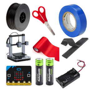

  1. 3D Printer
  2. Black PLA
  3. ~25cm of just under 5cm diameter ribbon
  4. ~6cm stick-on Velcro strip
  5. ~4cm insulating tape strip
  6. Scissors
  7. Micro:Bit
  8. Battery compartment (comes with each Micro:Bit)
  9. 2 batteries (to fit the battery compartment)
