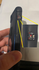

  1. The microphone chip is the sneaky thing that is hard to find but they all look generally the same with mild variations, as in (photo 1 and photo 2). Sometimes the piece as in my case is soldered to the bread board that pops out, which you will have to de-solder. It is probably best to buy a new microphone and wait for it to come in the mail before doing this because you may ruin your only microphone (see above parts link). Follow the microphone hole as seen in (photo 3), and it will lead you to the microphone chip, (photo 4). Pop it out (photo 5). De-solder the chip with a heat plate, then this is the tricky part: solder each plate (photo 6) to enameled wire (prepare your wire tip by burning off the enamel and pre-soldering it). Then connect the wires to their respective plates on the circuit board, leaving the positive lead long and soldered to the dip switch, out the side of your phone (photo 8) can remove the sim card jack permanently (I have a virtual sim card, so it is not needed), or find another hole to exit. You may not find the positive lead on the microphone (diagram, photo 9), so just pick one of the wires and connect it to the dip switch, any of them will dead short the circuit. The problem with this method is your microphone is now flopping around in the phone and makes for a bad microphone, so tape it down with electric tape, being careful to cover up the exposed leads. If any one knows a better way of doing this let me know, see number 2 method for possible easier method.

This step is easier than method 1 or 2 of the microphone kill switch. First you must locate the battery, at this time you may wish to buy a new battery off of eBay to replace the old one if your battery is dying as they all do eventually. Unplug the battery ribbon (photo 1) and cut a section out of the ribbon being careful not to cut through the next wire (Photo 2). Check to make sure there is not continuity, you must scratch of the ribbon gently with a blade so as to expose the metal underneath for which to place your tester (photo 3) and to solder your wires (photo 4). thread your 2 wires through the exit port of the phone and solder to the switch (photo 5). Tape your wires down to the battery with electric tape and close your phone up with all of the screws. Create a small square shaped hole in a phone case (photo 6) that you could buy, see ebay link above, and fit the switch into that (photo 7). These switches are surprisingly sturdy and due to being embedded in my case have not accidently gotten flipped by accident. Add your camera covers, may just go the cheap route and put electrical tape over your cameras or buy a camera cover (photo 8), or a phone case with a cover (link above). Your phone is now De-spyifyed.
