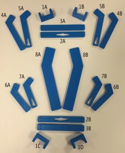

Step 1: Crafting Robot Parts
In this part you would first create the body parts: Legs, Arms, Hips & Shoulder for this four-legged robot.
The tutorial will be based on 3D-printed body parts. However, if you have access to a Laser Cutter, you could craft these parts much faster, but the bottom line is that your robot might loose some stability (I've attached the 2D design files needed for the Laser Cutter)
3D-Printing Robot Parts:
Download the Mimicry Robot Body Parts.stl file or go to this Thingiverse 3D Model to download the model (and even remix it however you like!) You are able to 3D-Print these parts perfectly using the standard MakerBot settings.
Cutting Using a Laser Cutter:
If you do not have access to a 3D-Printer, you can also download the 2D Design Model (Mimicry Robot Body Parts.dwg or .ai) of the body parts and use a thick material (e.g. 5mm thickness acrylic glass) to create the them.
Step 2: Sticking Body Parts Together
Now that you have created the robot body parts, you can start sticking them together using any superglue.
Process:
Start with sticking the two semi-identical pieces for the six main body parts to each other:
- 4A - 5A
- 4B - 5B
- 2A - 3A
- 2B - 3B
- 6A - 7A
- 7B - 6B
After the six main body parts are strongly attached together, attach two servo motor holders (1A, 1B, 1C & 1D) to the hips and two servo motor holders to the shoulder. Make sure that you test the orientation of the servo motor holders so that the wires would go inside the robot.
- 1A & 1B to shoulder
- 1C & 1D to hips

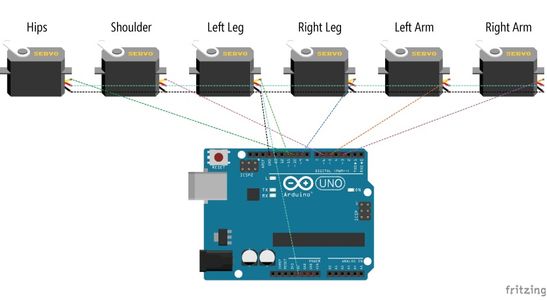

Step 3: Attaching Servo Motors
Now that you have the body parts prepared, its time to get every single limb to be powered by a servo motor.
Process:
The first step is to set the initial angle of the servo motors to 90 degrees:
- Attache the six servo motors to the Arduino according to the schematic.
- Program the Arduino with this code that would only set the angle of all servo motors at 90 degrees.
- Attach these servos: RightArm, LeftArm, RightLeg & LeftLeg to the Hips and Shoulder servo motor holders, and fix them using two screws.
- Attach the servo horns to the servo motors according to this:
- Shoulder and Hips use the full-size servo horns that are perpendicular to the servo motors (while they are set to 90 degrees.) Use a screw that would hold them tightly.
- Legs (that are smaller than arms) use the half-size servo horns that are perpendicular to the hips.
- Arms would also use the half-size servo horns. But they are perpendicular to the main body part (the biggest part) so attach them accordingly.
