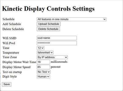

  3. Web Service Settings - Kinetic Display

  3. When in Admin mode, transmits its own Wi-Fi service to wirelessly change the display settings from a cell phone or computer.
