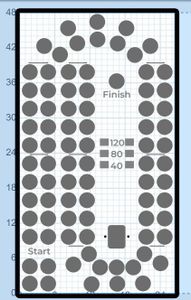

So this thing is going to be pretty big right? And I'm sure I'm not alone in my constant battle to fight clutter and stay organized so lets plan where this thing is going to live before we get started.
My first thought was to just flip over the top of the dining table and carve directly onto that, I mean how many fasteners does a tabletop really use right?
Turns out it had 3 different kinds of fasteners and bracing attached to the top and the sides plus some other hardware for the drawers that I underestimated... So yeah, that turned into a bigger project than I wanted to get "permission" for (still haven't told Wiferneer what's about to happen at this point, shhhh) so lets have a think on this one. Also, we like cribbage, but I don't feel I like it enough to look at it every day so carving the top of the table is out 😁.
Next thought was to have it as like a skin we could put on the table. A sticker, fabric something like that?
Sticker is out because it's too permanent. And I'm likely to smoosh up or knock off a piece of fabric while playing so we need something sturdier.
What if we still made it out of wood but mounted it under the table?! 🤔 Wood that work? Lets try it!

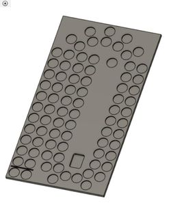

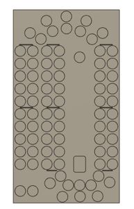

I measured the underside of the table (doggo "helped" 😘) at 26.5" x 48" and the diameter of a can (2.7") to do a rough layout (rectangular pattern in Fusion 360) with can sized holes and looks like it will work! Lets see if we can refine it and make it look more "cribbage-y."
I got it to a layout that looked like what I was after, but we had to make a few compromises.
  • There's no way to fit 3 rows on, so this is a 2 player game
  • While 121 holes will "technically" fit, it just ends up looking like a grid and not a cribbage board. So we're going to have to lap the board 3 times.
  • I did include markers so you can keep your opponent honest about what lap they're on!
  • There's no room for keeping score, we'll use a notepad if it gets that serious
  • There's also no room for a third peg, but that's for keeping score so the previous bullet kinda solved that...
All good, lets get the text on the board and get the file loaded into the CNC software. Preview looks good, lets do this!
(I've also included a .dxf file for a router template to make the 2.7 inch diameter holes. It is specific to my Bosch Colt router but I've also included the sketch showing how I made the template.)
