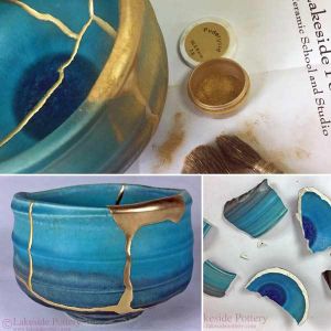

Step 1: Breaking to Bowl
Broken pottery can happen due to an accident of broken on purpose. Breaking vessels require some practice to insure the break is just right with aesthetically pleasing repair lines.

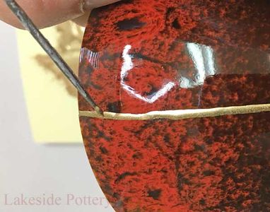

Step 4: Traditional Japanese Kintsugi Application Lesson Using Real Gold Over Lacquer
Apply lacquer with thin brush over the repair line in the desired thickness. Allow the lacquer to get a bit tacky before applying the gold powder. Place bowl over folder paper to collect the excess gold powder. Use very soft brush to apply the gold powder over the lacquer.
Wait until the lacquer hardness and brush off excess gold powder. Pour the fallen off gold powder in to the container.
Use soft cotton cloth to burnish the gold applied over the lacquer.

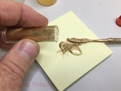

Step 5: Kintsugi Application Using Metal Alloyed Powder With Gold Effect
We use proprietary Encapsulating two part non-yellowing epoxy.
Apply about 35% metal alloy (consists of brass, copper and zinc) - not available for sale. Apply about 35% metal alloy (consists of brass, copper and zinc) and mix well. Use a sharp tool to carry the gold effect. Apply the desired width and thickness over the repair lines. Allow to cure before handling.
