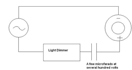

Step 1: Fast and Cheap Sparks
The first circuit we built was based on this schematic, that we found here, along with an explanation of how/why it works.
Materials needed:
x1 light switch dimmer
x1 ignition coil from a car
x1 1uF 220V electrolytic capacitor
This worked pretty well, and we made some fun sparks with it, but since the signal is more or less coming straight from the wall, its current is still pretty high, and it does not feel nice to touch the high-voltage wires. It would be pretty hard (and painful) to use this to take electro-pictures of living things.

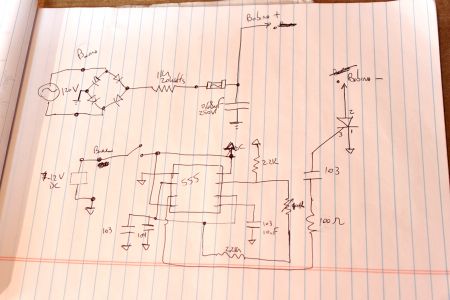

Step 2: Second Circuit: Control and Finesse
What is missing from the previous circuit is some current-limiting components (resistor and a fuse), and a way to flicker the transformer on and off at higher frequencies. Both of these things should contribute to a less painful and dangerous aura-imaging experience.
Here’s the circuit diagram for the final version of our Kirlian Machine. It is based on a circuit designed by some people in the 80s, and it uses an astable 555 timer to control the frequency at which the coil turns on and off.
You'll need...
x1 W06G rectifier
x1 1kohm, 20watts resistor
x1 500 mA fuse and fuse box
x1 680nF, 250V capacitor
x1 TIC126 thyristor
x2 10nF capacitor
x1 100 nF capacitor
x1 100 ohm resistor
x2 2.2kohm resistor
x1 100kohm potentiometer
x1 555 IC

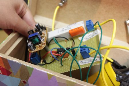

Step 3:
Here’s a picture of the circuit on a board. That huge white ceramic rectangle is the 20-watt resistor, and that big yellow thing to the right is the ignition coil.
Now we can take pictures of our hands and fingers and other body parts.
