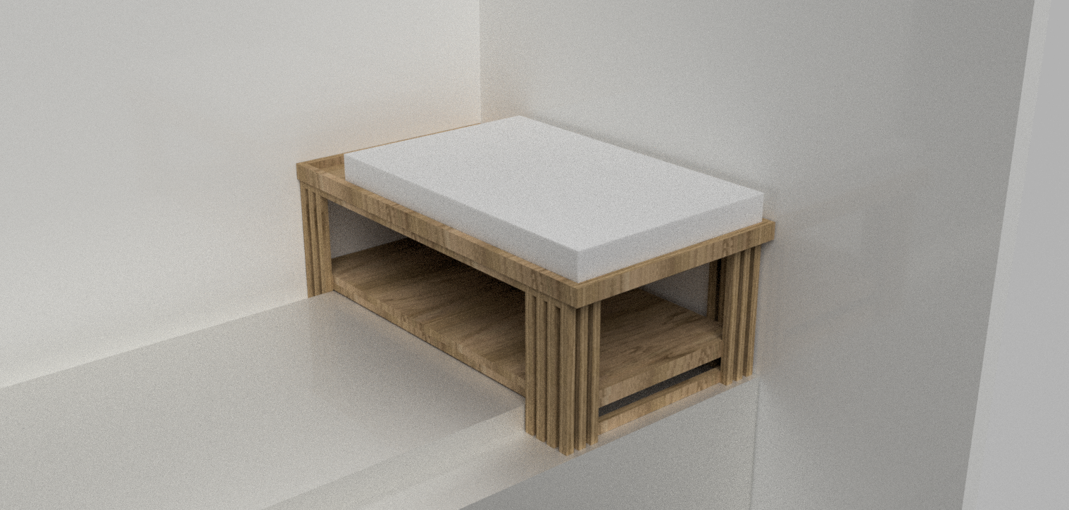

Step 1: Step 1: CAD Drawing and Gathering of Supplies
First step is to print the template of the kitchen helper. I have attached both the CAD drawing and the PDF of the model for easy access and modification if you want. The PDF is made so that the template is printed in A4 and it is easy to know where each paper piece fits together. The meaning is so that the two lines is supposed to overlap and that will make it correct (see image). The chair is 88 cm in height due to the height of my counter top, but you can change that if yours is higher or lower.
When everything is printed, glue/ tape the template on top of the plywood and then find your finest jigsaw and start cutting! Be careful to not cut inside the lines. We used 15 mm thick plywood and that worked fine for us. I think you can use thicker, but it will become heavier and less movable. Any thinner than 15 mm will become fragile so it's not advisable. It is best to cut a little bit outside the lines and then fine trim the edges afterwards with a router. When we did this, we made some changes to where the handles where so that is possible to do as well if you see fit.
It is EXTREMELY IMPORTANT that you do NOT cut all the way through on the slots that are horizontally and vertically inside the kitchen helper (see image with red rings). These cuts are to be cut out with the router later. Cut out all holes and notches and continue to the next step!
