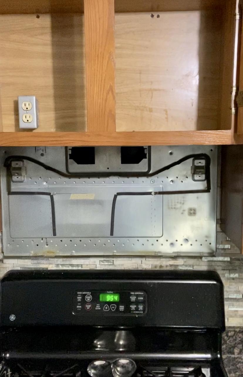

We inherited an over-the-range microwave that would recirculated over the stove and back into the kitchen. The equipped grease traps on that thing were very small (in my opinion) and this caused the cabinets, drop down, and ceiling over the stove to get super tacky / greasy = yuck! Our laziness got the best of us because if you're not consistently cleaning grease, it gets close to impossible to clean after a while.
We knew in order to make a kitchen renovation work, we first needed to control our grease (as odd as that may sound)! I knew I wanted a proper kitchen hood and did some research on installation, sound, quality, and CFM. I should also mention that I have a gas range, not electric, not induction.

Installation I was very fortunate with. It should go without saying but make sure the model you get fits your current situation. We removed the previously installed OTR microwave. This was held in place underneath by very long screws ~12-inches as well as from the top via screws that were removed from the upper cabinets. This left the back mounting plate (pic 1 & 2) exposed and needed to be removed as well. The previous house owners already had a vent to the outside that went horizontally out of the kitchen (pic 3 & 4). Some hoods will vent horizontally, vertically, or have an option for either. This left us with merely replacing the microwave with the hood.
The new hood's grease traps are large and dishwasher safe, which was another nice option. I just followed the manufacturers instructions for installation with the help of my partner (pic 5 & 6).

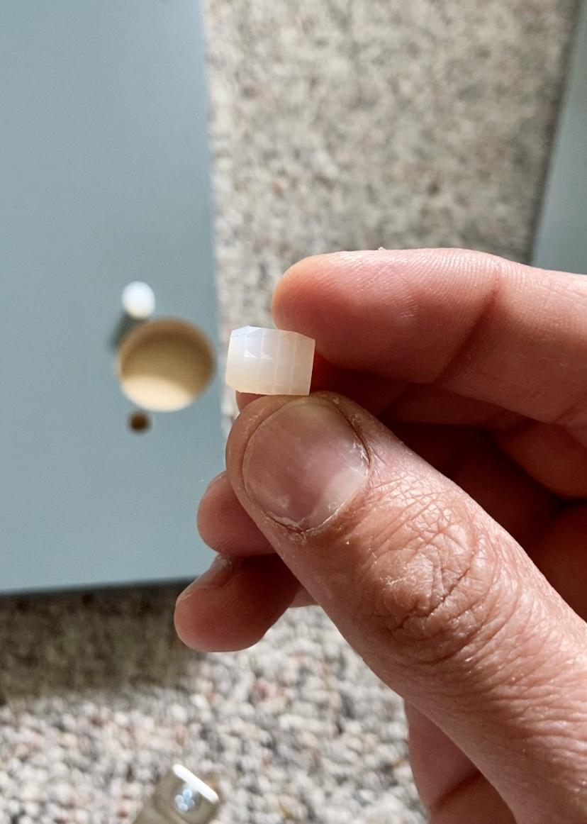

We found a company online that was a suitable and affordable option where we sent them the measurements for replacement doors and drawer faces (pic 1) and they sent us the cut and finished products (pic 2 & 3) via freight. We went through a correspondent to ensure our measurements were correct (I think we facetimed 3-4 times) and made the order in the color we chose. The doors also came pre-drilled for hinge installation to ensure they were at a 90-degree.
With that in progress, we took the associated paint swatch to our local hardware store to have it color matched (pic 4 & 5). We went with a mid-grade satin gallon of paint. We did not go cabinet grade because we were only doing the frame and not the doors and drawers. Had we only repainted the original doors as opposed to replacing them, then we would have gone cabinet grade. I felt comfortable with this option but in hindsight, I only used maybe a quart of the gallon in total for the whole kitchen cabinetry. And that included two coats (pic 6 & 7).
TIP: If you have one of those "fake drawer" faces that hide your sink basin, it may be very difficult to remove/reinstall. I had to get a special 90-degree ratcheting screwdriver to get the screws off. I am pretty sure I got several hand cramps manipulating this thing. It was a pain (pic 8).

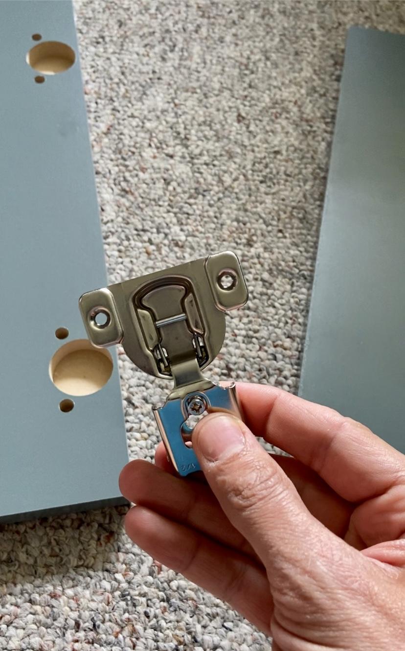

A popular brand of standard hinges we needed were Blum for 1/2-inch overlay (pic 9 & 10). These are what the company pre-drilled for so that was nice that they made the recommendation. I had 23 doors so that meant 46 new hinges. When the hinges came from the big box hardware store, they came with the hinge and screws. However, the pre-drilled holes on the doors arrived with the use of a dowel as opposed to a pilot hole for a screw. I thought they performed the wrong operation and I was in trouble. But I wound up ordering a 100-pack of dowel hinges and the associated 100-pack of screws (pic 11). Pound them in with a rubber mallet, screw in the hinges (pic12), and pound them flush and they were ready for installation.

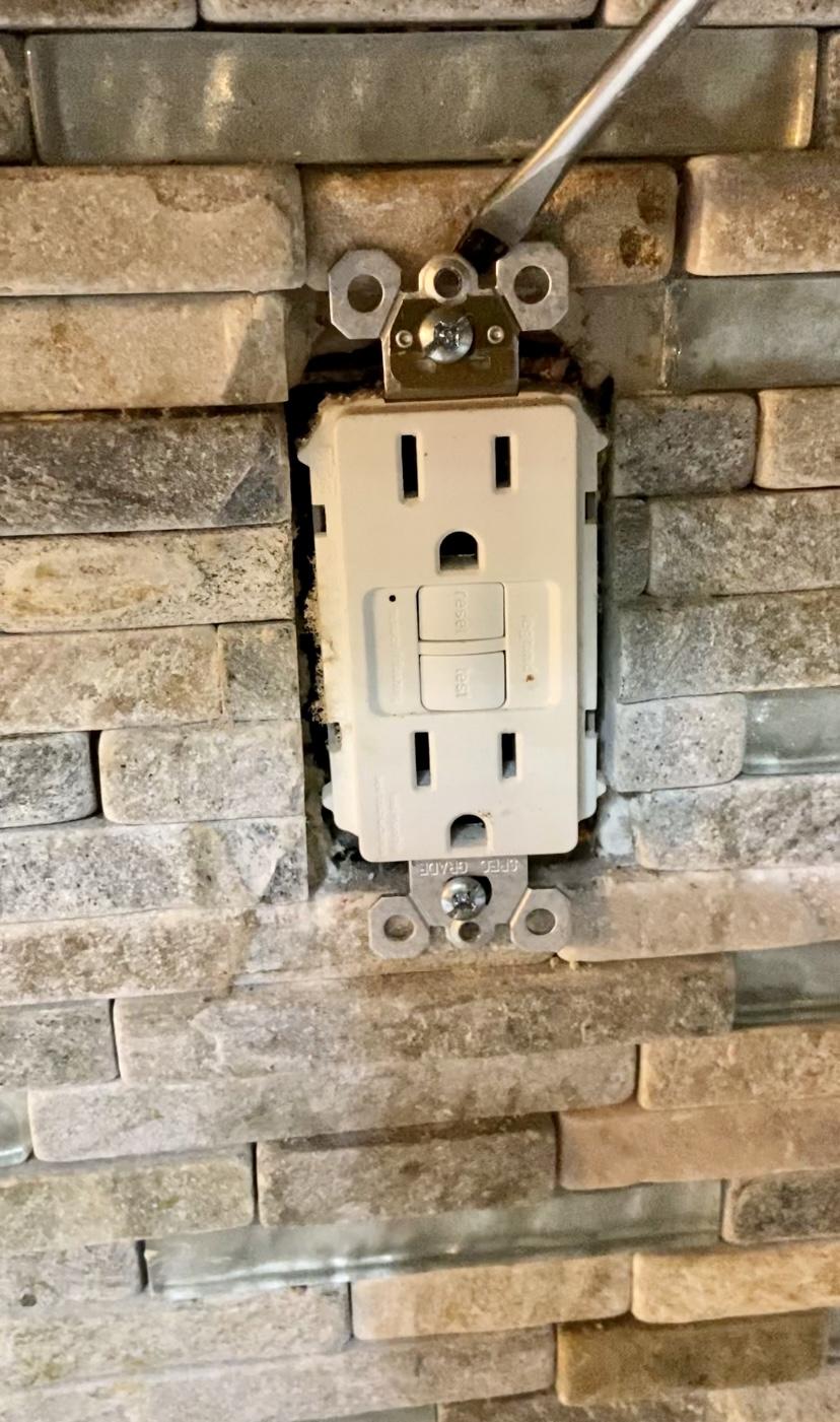

When removing backsplash tile, I was told to not use a claw hammer since it could damage the drywall (if you are gonna to that anyways it is a moot point)! I paired a crowbar with a drywall knife and worked my way around the grout/edges to carefully peel up the old tile. Slow and steady was the method since I do not like replacing dry wall (pics 1-9). The demolition was the easy part working from the edge but when I got to a corner I was stumped (pic 10). I didn't want to use the crowbar since I was afraid it would blow a hole in the unreinforced drywall. Luckily, the finger grooves of the old tile allowed me to take one single piece out of a middle section (pic 11 & 12) and work my way from the top down (pic 13 & 14) and not from the side. In retrospect, I could have started from the opposite edge but I didn't want to move my fridge nor did I think of that until it was too late...
If you are trying to save the installed drywall, smooth out the leftover thin set from the old backsplash because the last thing you want is to show imperfections in the new tile. I can see how the old finger joint type tile I removed can be nice to "hide" those types of imperfections but my new tile is flat and light. It would show peaks / valleys which is not good. I took a 4-inch heavy duty scraper (pic 18) to bust out the large high points. Low valleys can be filled in by spackle. The name of the game is flatness. I used my industrial roll of butcher paper (pic 19) to allow as a laydown for easier clean-up. I checked for high and low spots in the dry wall with levels and circled spots that needed to be filled or sanded down. I sanded / spackled (with the help of my daughter) and rechecked after the spackle dried. Repeat until satisfied and for me that was in the range of <1/16th of an inch (pic 20 - 30).
The previous backsplash also just kind of stopped on the wall and looked very amateur to me. No border, no accent tile, just bare tile. If you terminate behind an appliance like the refrigerator, no worries, right? I didn't want my tile by the doorway to just stop so I got some Schluter aluminum trim, cut it to length, and got those pieces staged (pic 31-33) for the new backsplash!

Dry runs helped immensely but the thing that worried me the most was cutting tile for spots around outlets (pic 2). The last thing you want to have laid all your backsplash tile only to have to chip/grind portions away to make room for the outlet cover. I came across a very good YouTube video by the Stud Pack. They took a little piece of spare 1/2-inch plywood, took their outlet cover, and cut the block to remove 1/2-inch. They call it the Groutlet (hilarious & handy). For example, my standard two outlet cover is 3-1/8 x 5-inches, therefore, my groutlet block was cut to 2-1/8 x 4-inches (pic 3). This gets screwed into place where the actual outlet would get screwed in to. I can then cut/lay my backsplash flush to the groutlet and not have to worry about reinstallation of the cover afterwards. And you know what? It worked like a charm! Even for my triple cover meaning an outlet cover that was 2 switches and 1 double outlet (pic 4 & 5).
Obviously, cut the power prior to manipulating any home electrical: BE SAFE and verify power is removed prior to servicing!!!

Door hinges are on and ready for installation (pic 1).

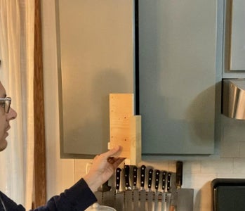

Predrill your holes to allow for the pre-described overlay (mine was 1/2-inch) and drive your screws in. I leveled my double doors with the help of my partner and installed the first one. I left a 1/16-inch gap between the doors. The nice thing about he Blum hinges is that you can adjust the vertical/horizontal plane they fall on with adjustment screws. Following the manufacturer's direction was quite simple and got those tiny imperfections corrected (pic 2-4).

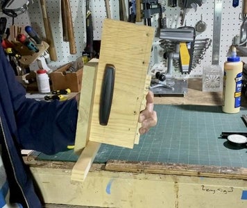

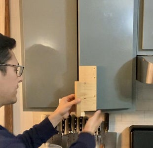

Doors were knocked out one by one (pic 5) and now I need the handles to be installed. For reproducibility = jig creation (pic 6)! I did this quite simply to allow 1 jig to drill holes for a left handed door and a right handed door whether it is above or below the countertop. Basically, the guide holes are drilled on a scrap board that has stops for the side and bottom of the door. I drilled the holes with the jig clamped since holding it by hand introduce some wiggle and that doesn't make for good level handles (pic 7 - 16).
