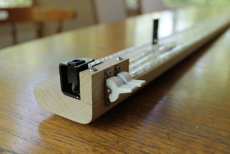

Step 3: Wiring
I found two simple switches and a 2.5mm power jack in my parts bins and attached with a bit of metal and wood work. One switch powers 12vdc to the task lighting and the second switch controls the upper decorative light.

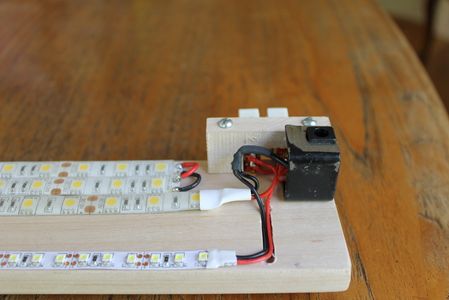

Step 4: Close Up of Wiring
In this picture you can see how I used a Dremel cut a channel to bury the upper LED wiring so the wood would sit flush against the shelf.
