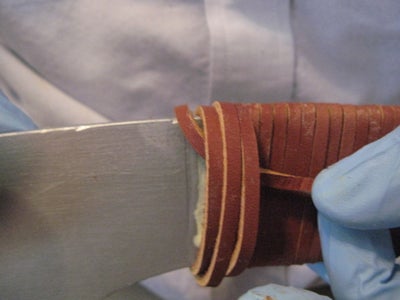

Step 7: Handles
I wrapped the handles in flat (about 1/8" wide) leather cord. Some rough calculations suggested I'd need about 35 feet of it so we bought a 50 foot spool.
More careful measurements suggest that a 5" wrapped handle requires 134 inches of leather cord. More for a larger bat'leth as the handles will be wider.
For each handle, mark off the 5" handle area, and put a generous serving of wood glue on the area (including the two edges).
Then do a tight spiral wrap, tucking the two ends of the cord under the spiral wrap. Work quickly so the glue doesn't set before you're finished so you can clean it.
Tucking in at the start is easy. At the end is a little harder. Make the last three loops loose, and pull the end through. Tighten the loops, and then cut the end. Shove some more glue in.
Wipe excess glue and clean the glue off the cord. (If you worked quickly, the glue wouldn't have set.)
Then clamp. I wrapped the handle with aluminum foil (so it wouldn't stick or get dirty) and put it in a woodworking vise for a couple of hours. Repeat.
Finally, I touched up a few areas of the paint which got scratched in the process or got some glue on them.
