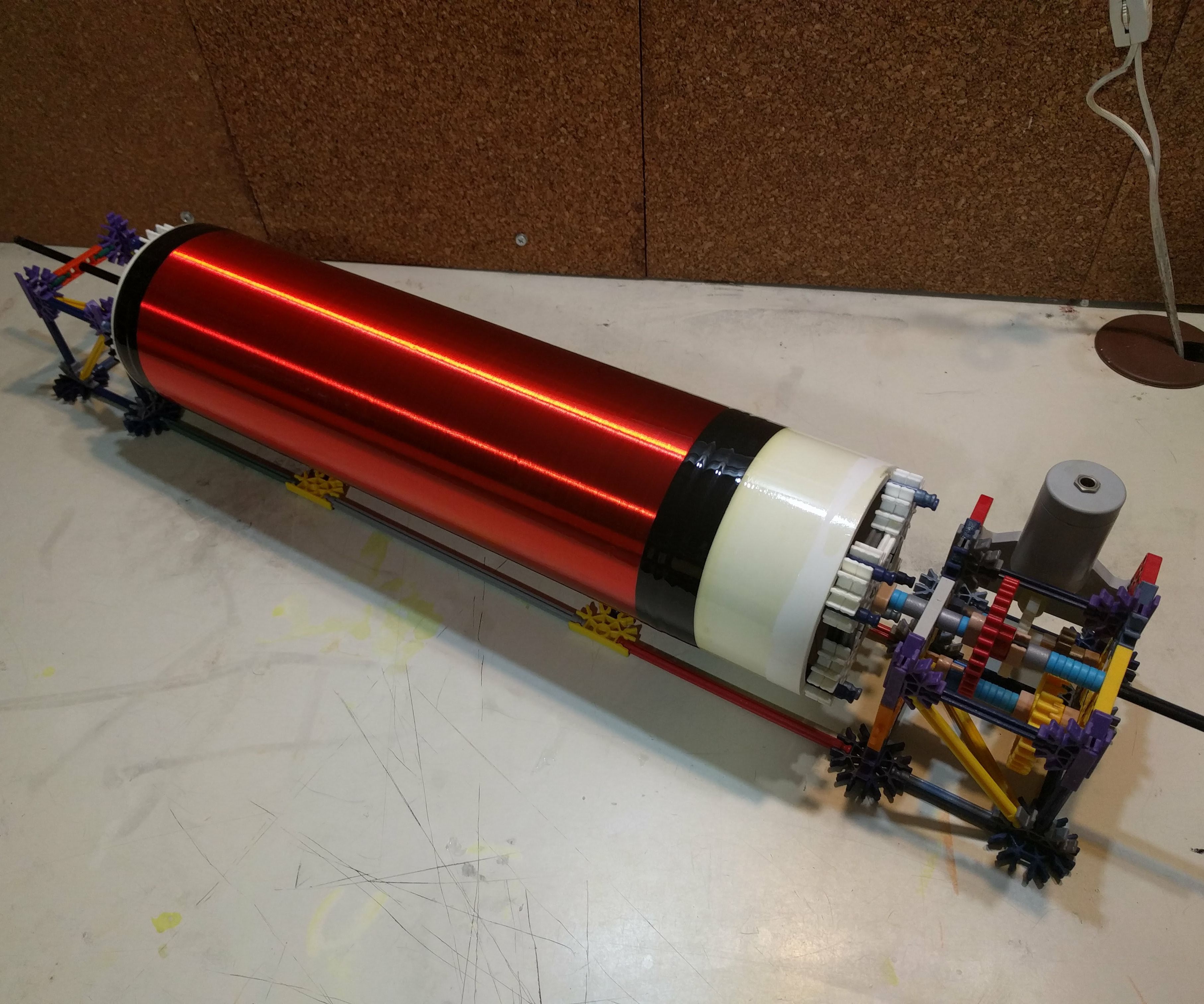

Introduction: K'nex Automatic Transmission DD-CVT
Welcome to my Instructable on how to make a k'nex automatic CVT!
A CVT is a Continuously variable Transmission. A CVT is able to achieve an infinite number of gear ratios within its range while the input rpm stays relatively constant. This eliminates the need for shifting and can keep the motor/engine running at its optimal rpm.
This differential is a Dual Differential CVT (DD-CVT) which uses two differentials connected in parallel to achieve a continuously varying ratio. This transmission has an output to input ratio range of 0:1 to 1:1. If a 0:1 ratio is not desired a ratchet can be added to change the range to 1:5.9 to 1:1.
This CVT is not a perfect design. It can be quite inefficient at lower gears (more in "How it works") However the main benefit of this design is that it requires only one input, the motor. Pretty much all other transmissions and CVTs require 2 or more inputs to change ratios. (at least in my research)

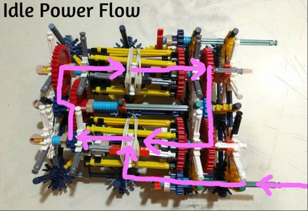

When an excessive amount of torque is applied to the point where the output stops, the transmission goes to an idling state. In this idling state power is still provided to the input which is spinning the first differential. Because it is under high torque, the power is sent to the geared down side of the differential. Now because the output is stopped by excessive torque, the second differential does not spin, instead the power goes through the differential and causes the 1:1 gears to backspin. When in Idle, torque is still applied to the output. This allows the transmission to idle. If this feature is unwanted, a ratchet mechanism can be added to prevent idling.
Note that this transmission does not convert torque. But is designed to provide a constant torque though an infinite array of speeds. Any extra torque acquired at low gear is dissipated through friction. This friction is necessary to achieve the higher gears for more speed. Because of the friction at lower gears, this transmission is most efficient at its highest gear ratio.

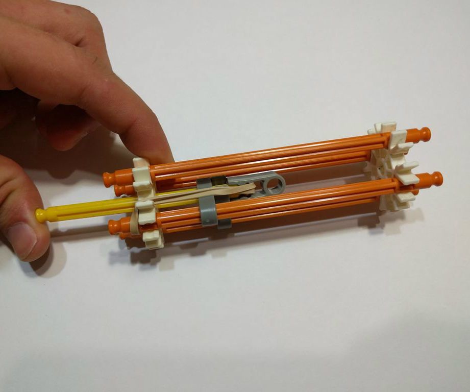

This is my ratchet solution. It uses an orange connector over a red gear, armed with a rubber band.
For those who do not want the transmission to idle, the ratchet will prevent idling. This provides greater torque output for the lower ratios. It can be quite noisy though.
