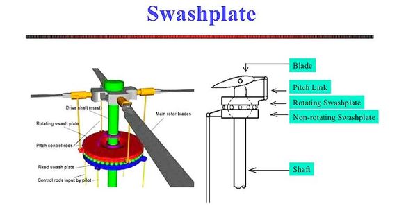

Collective pitch and helicopter orientation are both controlled by a swashplate. You might see on a helicopter a small, vertical stick beneath each of the blades. Those are what control the angle of attack of each blade. The swashplate can move up and down to produce lift, but can also rotate forward, back, and side to side to control each blade as it spins. As the blades rotate, they will be pushed slightly to achieve different angles of attack based on where they are, based on the controls. Each of these sticks is connected to a non-rotating plat further beneath the blades and moves based on each control. This is confusing, yes, but will make more sense with an example.
Let's say you're flying upward, and want to move the helicopter forward. You push the stick slightly forward, which will cause the helicopter to go forward. The fixed section of the plate will lean forward, and push the free-rotating disc above it forward as well. As the blades pass by, they will be forced upward slightly as they go toward the back, then down as they go forward. This will produce less lift in the front and more in the back, causing the helicopter to lean forward. This works the same for all pitch and roll controls.
