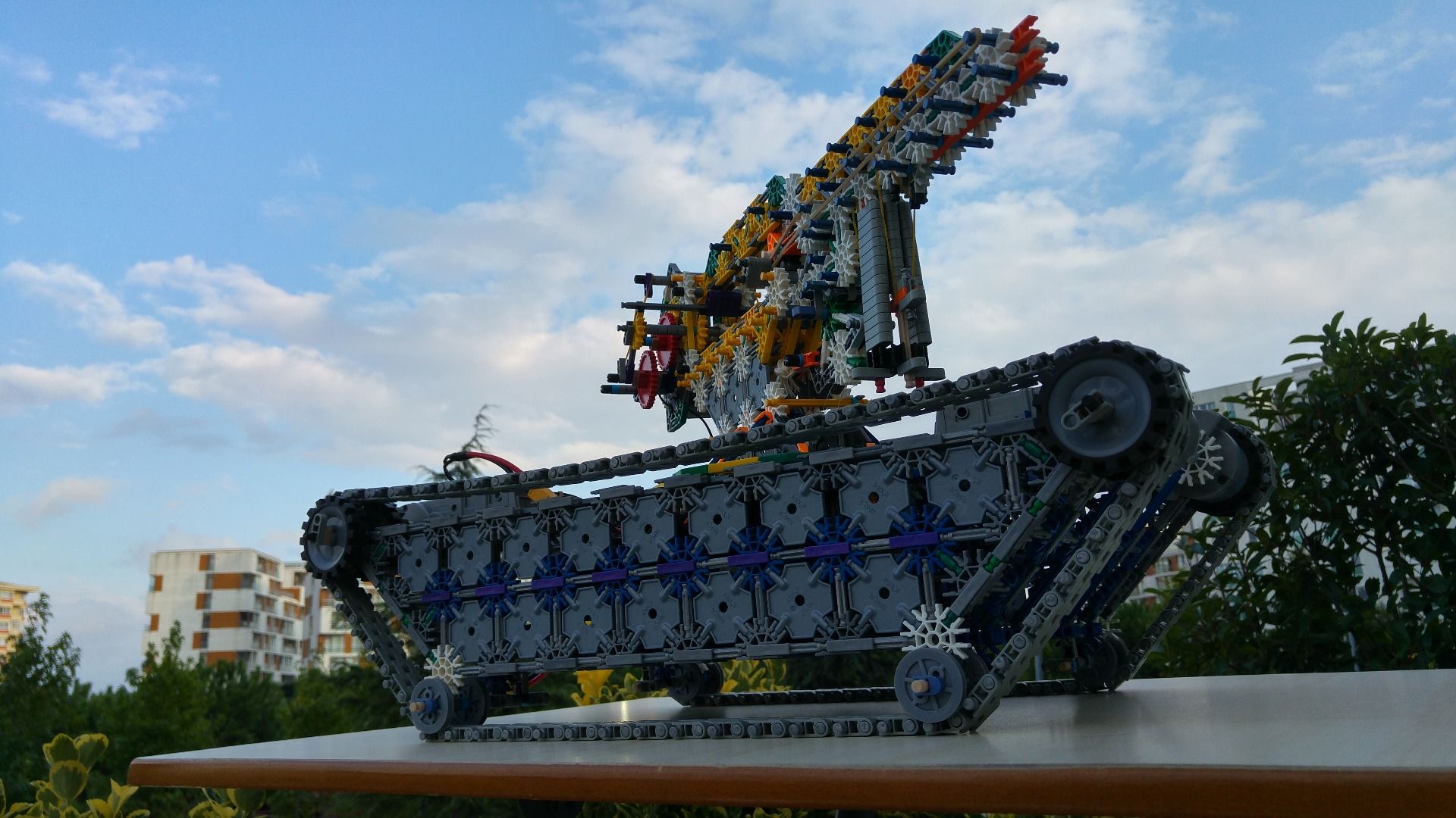

This was a great obstacle for my RC Tank - Altay.
There was another requirement for my RC Tank project, preparing the motors to be remote controlled. So I dismantled all the motors and made these two modifications.

Step 6: The Result
The result is a happy builder and a tank that moves the way it should...
Altay ready to move
Altay K'nex RC Tank instructable
