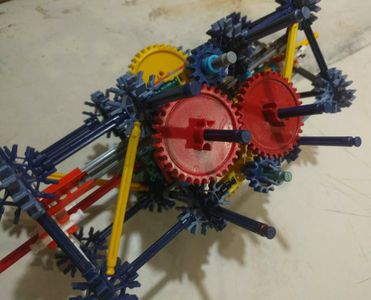

Step 6: Gearing
In order to power both pinion gears from a single input, I built a gear train connecting them. The challenge of this though is that both pinion gears had to spin in opposite directions. building a 3 gear train would have made them spin in the same direction. To make things even more challenging, both pinion gears had to spin at the same speed, which required a symmetrical gear design. So I had to design a symmetrical 4 gear train to solve this problem.
- Connect 6 blue rods to the blue and red connectors.
- Add the 2 red gears to the blue rods on the red connectors.
