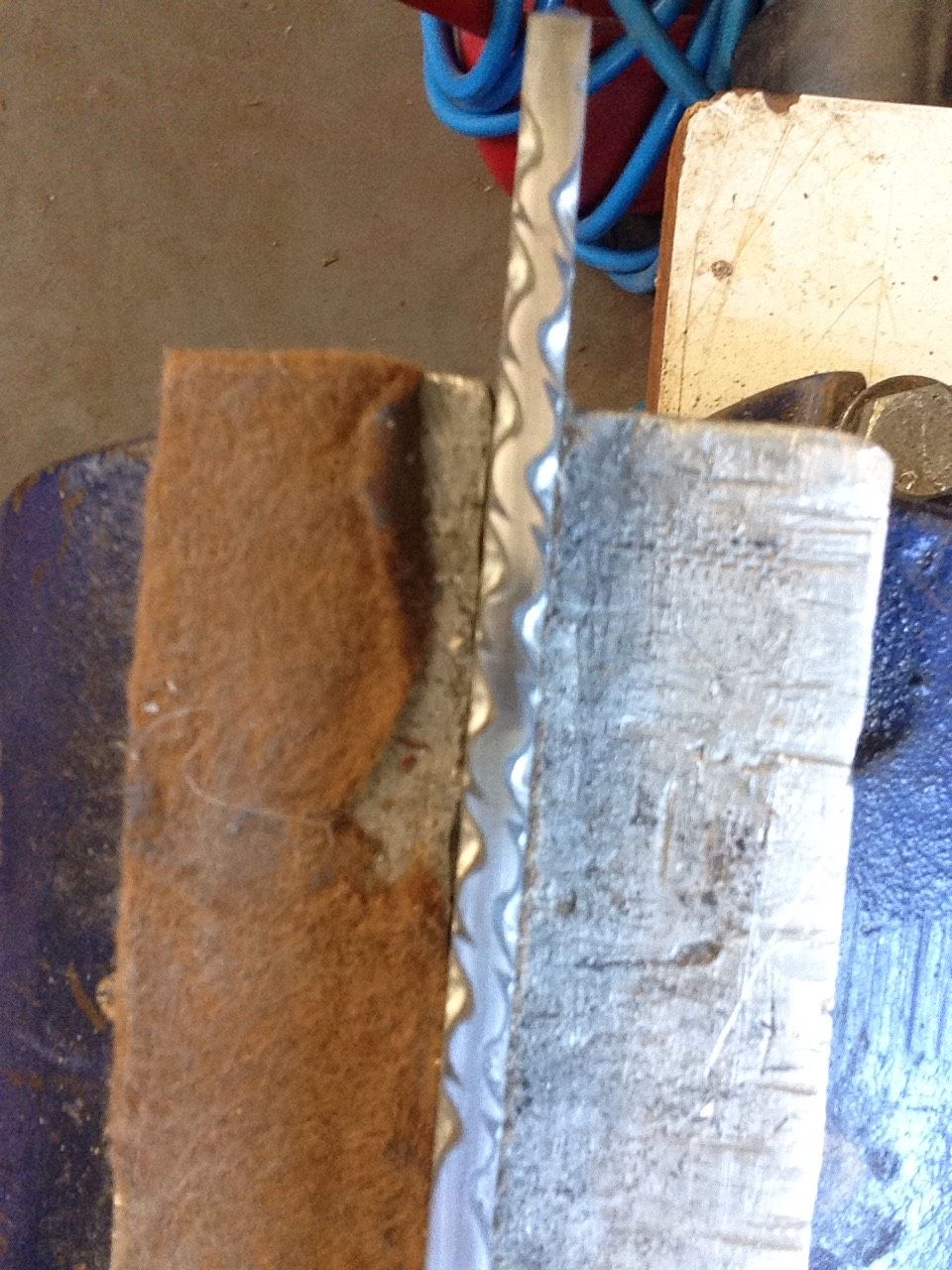

Step 2: Filework
This step is optional and is purely for design and appearance. I had as little search on google to see what kinds of file work there is and there are heaps. you can design your own pattern or find one you like. i decided to use the vine and thorn pattern as there were many tutorials on it. I practiced first on some spare steel i had that was the same thickness as my blade so i wouldn't stuff it up on my knife.Unfortunately i don't have any picture of those steps as i forgot to take them. There are many tutorials on this site for the same kind of pattern or you could google it. I think it turned out pretty well but in hindsight i wish i made it extend from the handle to about halfway on the blade as it would look pretty cool.
