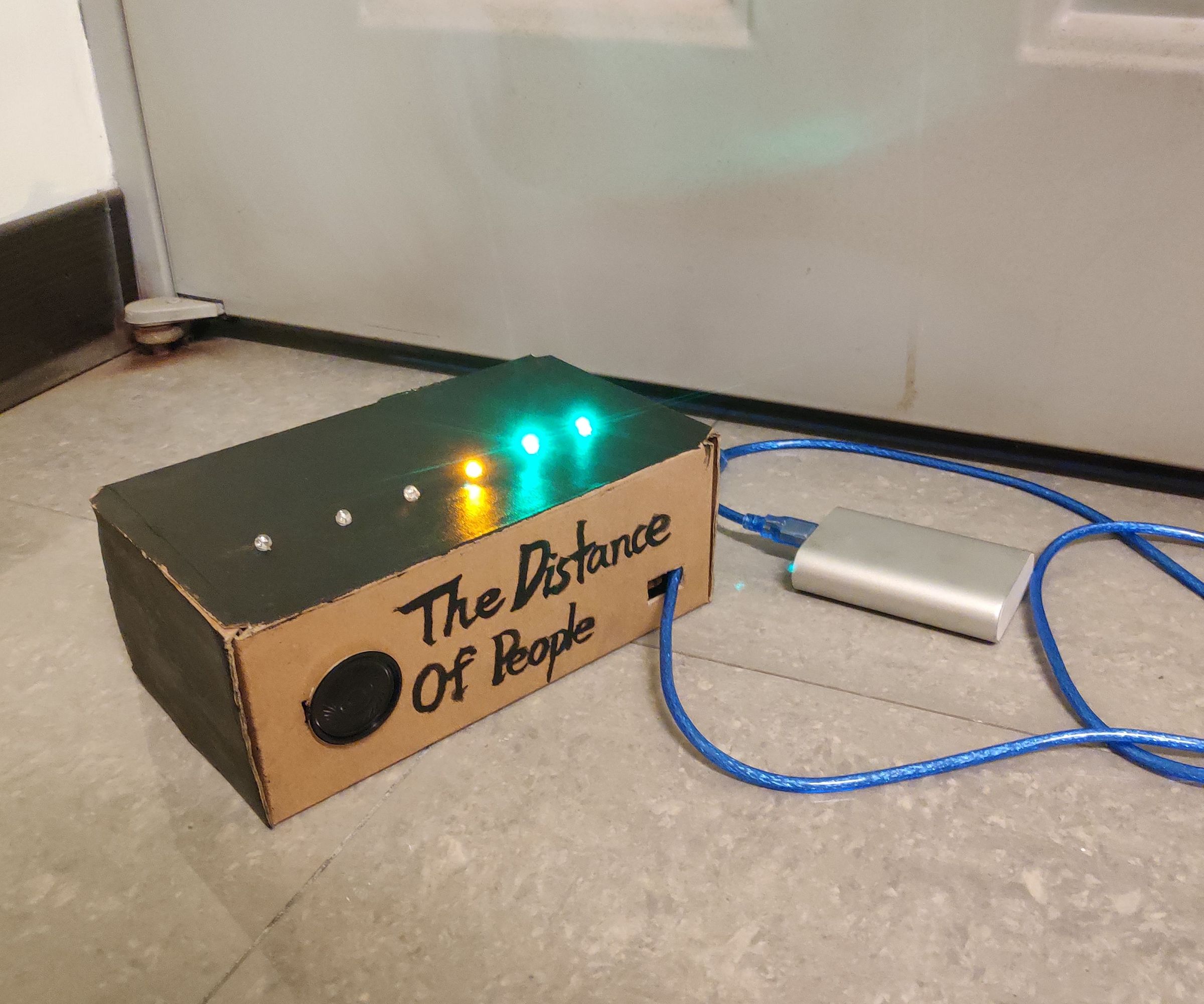

Step 1: Step 1: Materials
Before we start to make our project, we need to prepare these materials.
The Materials needed for this project are:
  • (1x) Arduino Leonardo
  • (6x) Photoresistors
  • (16x) 100Ω resistors
  • Male-female jumper wires
  • Male-male jumper wires

Step 3: Step 3: LEDs Circuit
The photo above shows the setup of the project. First, we connect the circuits of the LEDs. The jumper wires should be connected as follows:
First,
Connect a jumper wire from the 5-volt pin on the Arduino to the bottom channel of the breadboard
Connect another jumper wire from a ground pin on the Arduino to the upper channel of the breadboard
Second,
LED1 and LED4 -> red LEDs
LED2, LED3, LED5, and LED6-> yellow LEDs
LED7 -> blue LEDs
LED8 -> green LEDs
(In Order from Right to Left)
LED1 -> D-pin 4

Step 7: Step 7: the Codes
I wrote the codes by the Ardublocks.
Now that you have finished the physical setup of the build, now its time for the code. I assume that you already have the Arduino program on your computer, so now all you have to do is copy and paste the code from the link.
