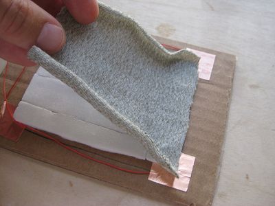

For demonstration purposes I wanted to get the largest rectangle possible out of the glove and cut this from the palm section. I cut it so that the knit does not run diagonally, but from side to side and from top to bottom.
To mount this piece of knit, which likes to roll up on itself, I cut a piece of cardboard, about 2cm larger than the knit all around and mounted it on some strips of squishy double-sided sticky tape. The reason I chose to use squishy tape was only because it was the only kind I had that day, but I also thought it could be nice than a hard surface and to some extent the surface is even pressure sensitive, since the harder one presses, the better the electrical connection becomes. Increasing electricity flow equally to all measuring points.
Before sticking the knit to the tape I connected 4 wires to the corners of the cardboard by stripping their ends and simply fastening them down underneath a small corner of copper tape that has conductive adhesive.
Step 3: Connecting the Touchpad
After sticking down the knit I connected its corners to the copper tape at the corners by simply sticking another small squares of conductive fabric tape with conductive adhesive. Be sure to check that the fabric tape is sticking well to both the knit and the copper.

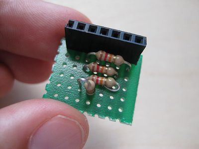

I actually made a silly mistake here in my circuit. Not that it doesn't work, it just does not plug in directly to the Arduino. So you can either follow my faulty version which is also what the pictures are of, or you can follow the text bellow that offers a more ideal way of connecting.
MY WAY
Cut a 6 x 7 hole piece of perfboard (copper lines running the shorter, 6 hole, length). Cut a row of 7 female headers and solder them to the first row of 7 holes. Solder 20K resistors between the third hole and each of the 4 holes next to it. Also see photos for instruction.
Solder the ends of all four (red) cables coming from the corners of your knit touchpad to the other end of the perfboard so that each input runs to the ground through a resistor. Solder the (red) wire coming form the finger cap to one of the two leftover holes on the perfboard that does not pass through a resistor and goes directly to the header. To connect this version to your Arduino you will need to use a piece of rainbow wire that connects things in the right way. The inputs from the four corners should go to your first four analog inputs. The header that is connected to the other end of all the resistors should go to your GND and the header that goes directly to your finger cap should connect to the +5V. See photos!
BETTER WAY
Cut a 6 x 9 hole piece of perfboard (copper lines running the shorter, 6 hole, length). Cut a row of 4 male headers and solder them to the first four holes in the row of 9 holes. Cut 2 male headers and solder them to the last two holes in the same row of 9 holes. Solder 20K resistors between each of the 4 male headers and the closest of the two male headers - these match up with your Arduino board. Solder the ends of all four (red) cables coming from the corners of your knit touchpad to the other end of the perfboard so that each input runs into a resistor. Solder the (red) wire coming form the finger cap to the left over header in the corner. Now this should fit directly on top of your Arduino and should be able to plug the male headers sticking out of your perfboard into the first 4 analog inputs and the two headers should plug into your GND and +5V. See sketch!
