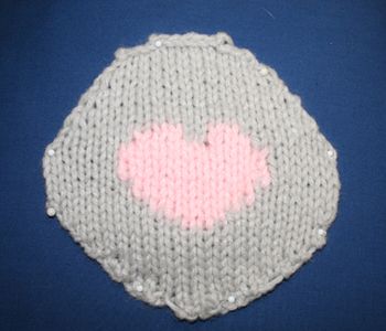

Step 2: Heart Circle
Heart Circle (make 6)
Using light grey yarn and 5mm needles, cast on 4 stitches
Row 1: Purl
Next 2 rows: Continuing in st st, cast on 2 stitches at beginning of row and increase at end (10)
Increase at both ends of next 3 rows (16)
Increase at end of next 3 rows (19)
Row 10: Begin placement of heart. Knit 9 grey, 2 pink, then continue in grey, increasing at end of row (20)
Continue following graph for heart appliqué while continuing with the following shaping.
Row 11: purl
Row 12: increase both ends (22)
Work 6 rows st st
Row 19: decrease both ends (20)
Row 20: knit
Row 21: purl
Row 22: Decrease both ends (18)
Row 23: purl
Repeat rows 22 and 23 two more times (14)
Row 28: Decrease both ends (12)
Next 2 rows: Cast off 2 stitches at beginning and decrease at end (6)
Cast off.

Pin a circle heart piece to the centre of each side and stitch in place, leaving a small gap. Add a small amount of stuffing and close gap.
