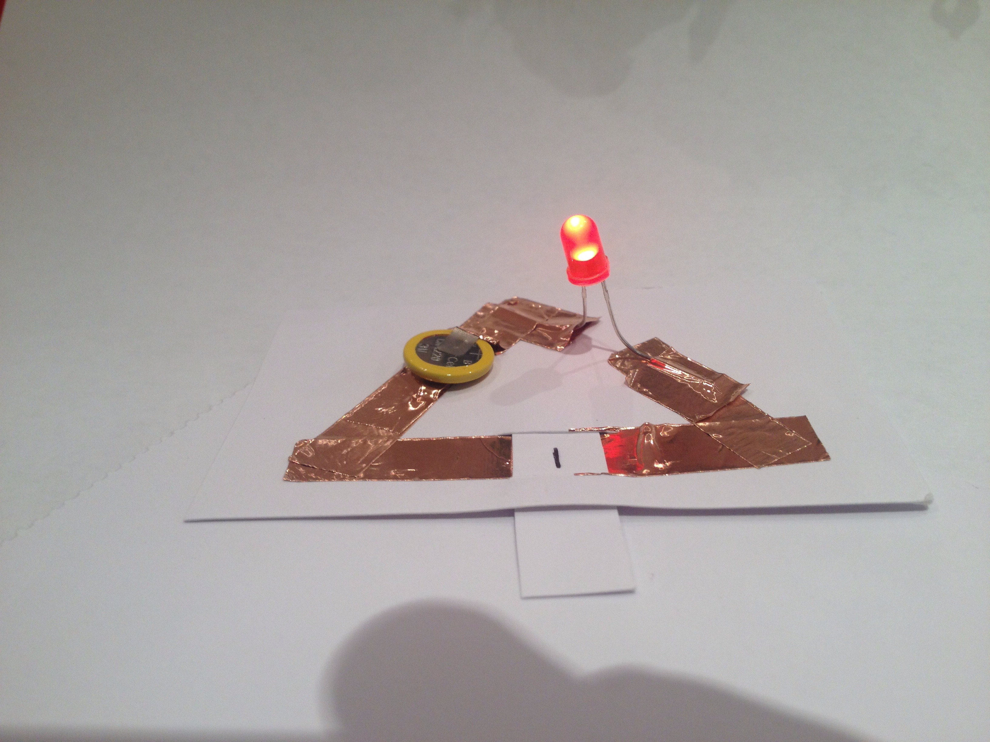

Step 4: Attach Copper Tape
Fold the paper strip into a triangle and attach a 3/8" x 1" piece of copper tape to the bottom.
Step 5:
Using the twist awl or the craft knife make a small hole in the bottom of the switch.
Step 6: Layout the Circuit
Layout copper traces about 5/8" an inch apart and insert fasteners on the end (this is to insure good contacts with the switch). For aesthetic purposes, you can cover the fasteners with copper tape.
Step 7: Get It Together
Add the components:
Apply copper tapes to the tops of the battery and LED leads and fasten the switch to the middle of the gap.
Step 8: Mission: Accomplished
By twisting the switch, the copper makes contact with copper. You now have a complete circuit.

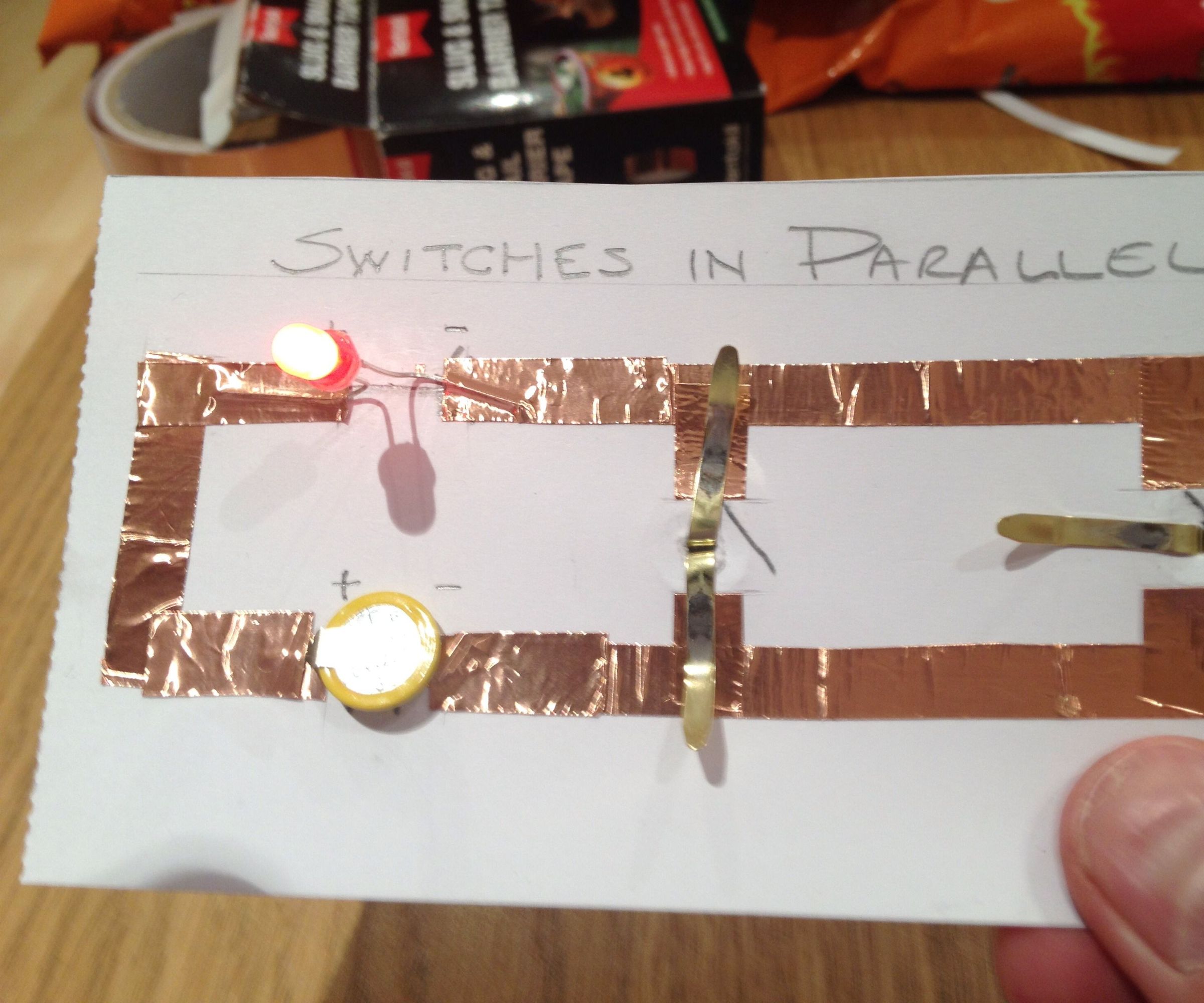

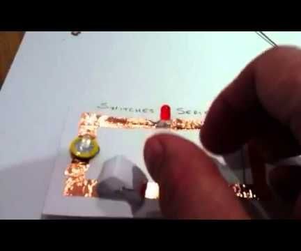

Step 9: Variations, Improvisations, and Meditations
I originally intended to make the knob switch with conductive paint, but ran out. As soon as I get more, I'll try making a switch with it. But I must say I'm happy with copper tape and think it would make an excellent medium for teaching electronics.
As you can tell from my sketches, I wanted to make a small plastic knob. If anyone knows of a good source of plastic bits in the UK, please let me know. I'm also exploring ways to make the switch more two-dimensional, maybe I'll make a switch that you can move with a pencil point.
