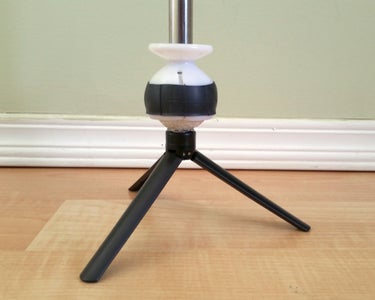

This instructable describes the solution I came up with. It is still an adjustable tripod head, but with a simpler design than what is used in conventional tripods to get things level -- no legs to lock, levers to adjust, or knobs to tighten. The key was to replace the small smooth ball with its opposite: a large rough ball. Now I just drop this setup on the ground, level the phone, then let go. After taking the photo, I pick it up then move on to the next shot. Perfect for the lazy, impatient, cheap amateur.

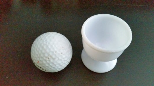

- An old golf ball in decent shape
- An egg cup made of thick, hard plastic (I found one at Dollarama)

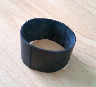

- A piece of bike inner tube about 1" in diameter, or rubber bands

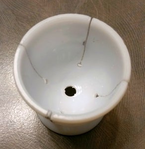

Step 2: Prepare the Egg Cup
Drill a 1/4" hole at the bottom center of the egg cup. Do this by hand (or very carefully with a power drill) because the cup can crack easily.
Mark four equally spaced lines along the sides of the egg cup. Use the seams as guides. Using the hacksaw, cut along the lines to form four "petals". Make each cut such that there will be a circle about an inch in diameter remaining at the bottom of the cup.
Test the depth of the cuts by gently pushing the ball into the cup. Because the diameter of the average egg is a bit smaller than a golf ball, it probably won't go in all the way. So don't force it -- you just want the petals to flex enough without cracking. If you feel resistance as you push the ball in, cut a bit more. If you get a crack (as I did), you might still be able to use it as long as there's enough remaining material to form the petals.
When satisfied with the cuts, clean them up by sanding down burrs and sharp edges. Round off the corners of the petals, leaving about 1/4" between the corners.

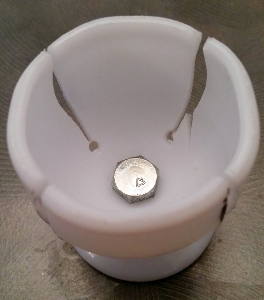

Step 3: Shape the Petals Into a Socket

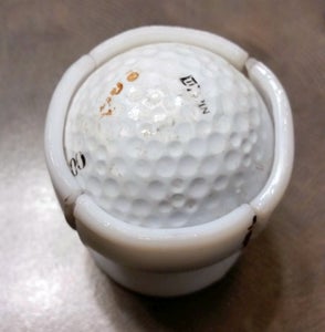

Using the heat gun, gently heat the petals near the base until they are just too hot to touch. Push the ball inside the cup, spreading the petals. Prepare a rag or gloves to protect your fingers for the next steps.
When the ball is fully inside the cup, heat it up again a little, this time focusing on the ends of the petals. Curl the ends of the petals so that they wrap around the ball. Aim for symmetry. When done, let the cup cool down.

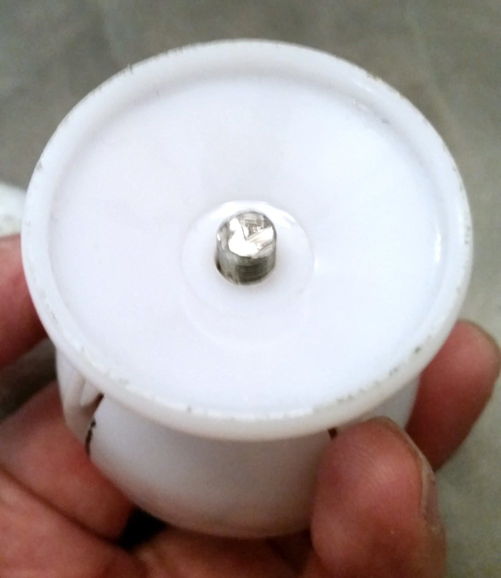

When cup has cooled, remove the ball by pushing a rod through the hole at the bottom of the cup. The petals should open up easily and return to its new shape. Trim the cuts a little more, making sure that there is at least 1/8" space between the petals. The egg cup is now a socket.
Note: heat the petals slowly and evenly. Patience is important. If at any point the petals start to deform without being touched, you've heated it too much. Avoid heating the stem and focus the heat on the petals, both inside and outside the cup. If the cup is too deformed, you can't fix it so start with a fresh one.

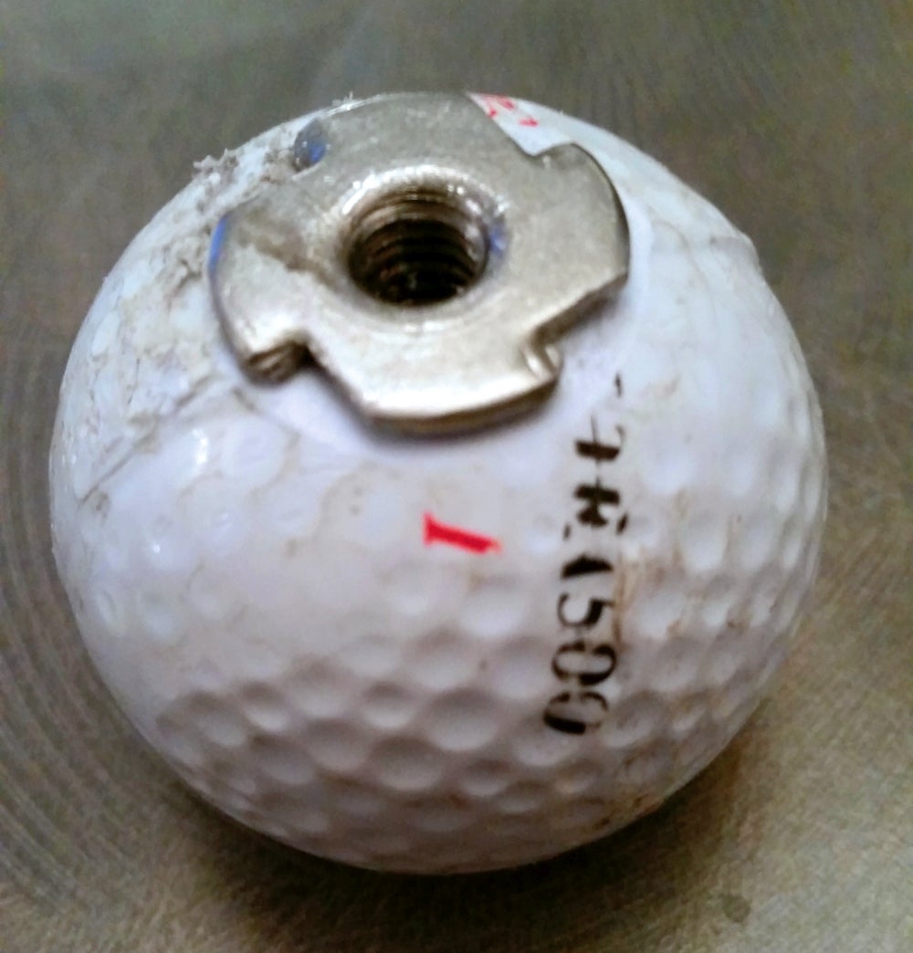

Step 4: Prepare the Ball

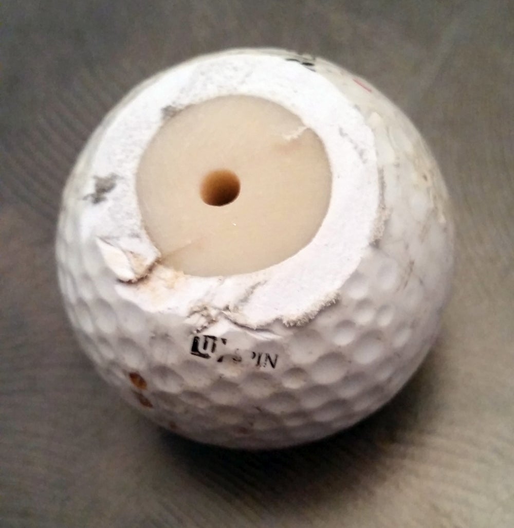

Drill a hole on the golf ball deep and wide enough to insert the tee nut. Aim the drill bit towards the center of the ball.
Using a sander or sharp knife, flatten an area around the hole slightly larger than the diameter of the top of tee nut. The goal is to get the tee nut to sit flat on the ball.
On the opposite side of the ball, cut or sand off about 1/2" to form another flat area. The two flattened areas should be approximately parallel to each other. Place the bolt inside the socket, then push the ball in with the tee nut facing out.
Attach the mini-tripod to the tee nut on the ball, then test the clearance between the ball and the bolt head by swinging the tripod in different directions. The ball should be able to swing at least 5 degrees in all directions inside the cup. If not, trim off more from the ball.
When satisfied, take out the ball from the socket. Hammer in the tee nut to the ball, and glue the bolt to the socket.
Note: you can also use a hex nut instead of the tee nut, but it might be more difficult to attach the hex nut to the ball. Remember that if the nut is outside the ball, the ball will sit higher above the tripod and the setup will be more unstable.

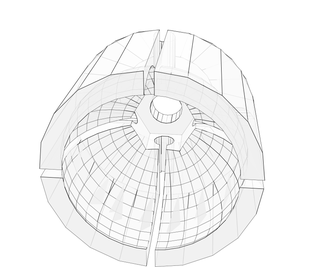

Step 5: If You Are 3D Printing This...
Before you print, measure the head of your hex bolt if fits the space I made for it in the model. Do the same with the tee nut. If you are using a hex nut, you have to modify the model to accommodate it.
You will also have to remove the pins on the tee nut. You can do this by folding a pin up with pliers, then folding it back down. The pin should snap off after repeating this a few more times. Just sand off the burrs on the underside where the pins broke off so that the tee nut will sit flat on the ball.
When done with the prints, take off excess material from the ball and socket. Do not sand the ball and the inside of the socket smooth -- you need some friction between them. Glue the bolt and nut in their places.
Note: I printed the ball and socket using PLA at the default setting on my printer, which is 0.2 mm accuracy, 20% infill density, and a clearance of 0.25 mm between the ball and the socket. If you use another material or setting, make sure the socket remains flexible enough to let the ball in.

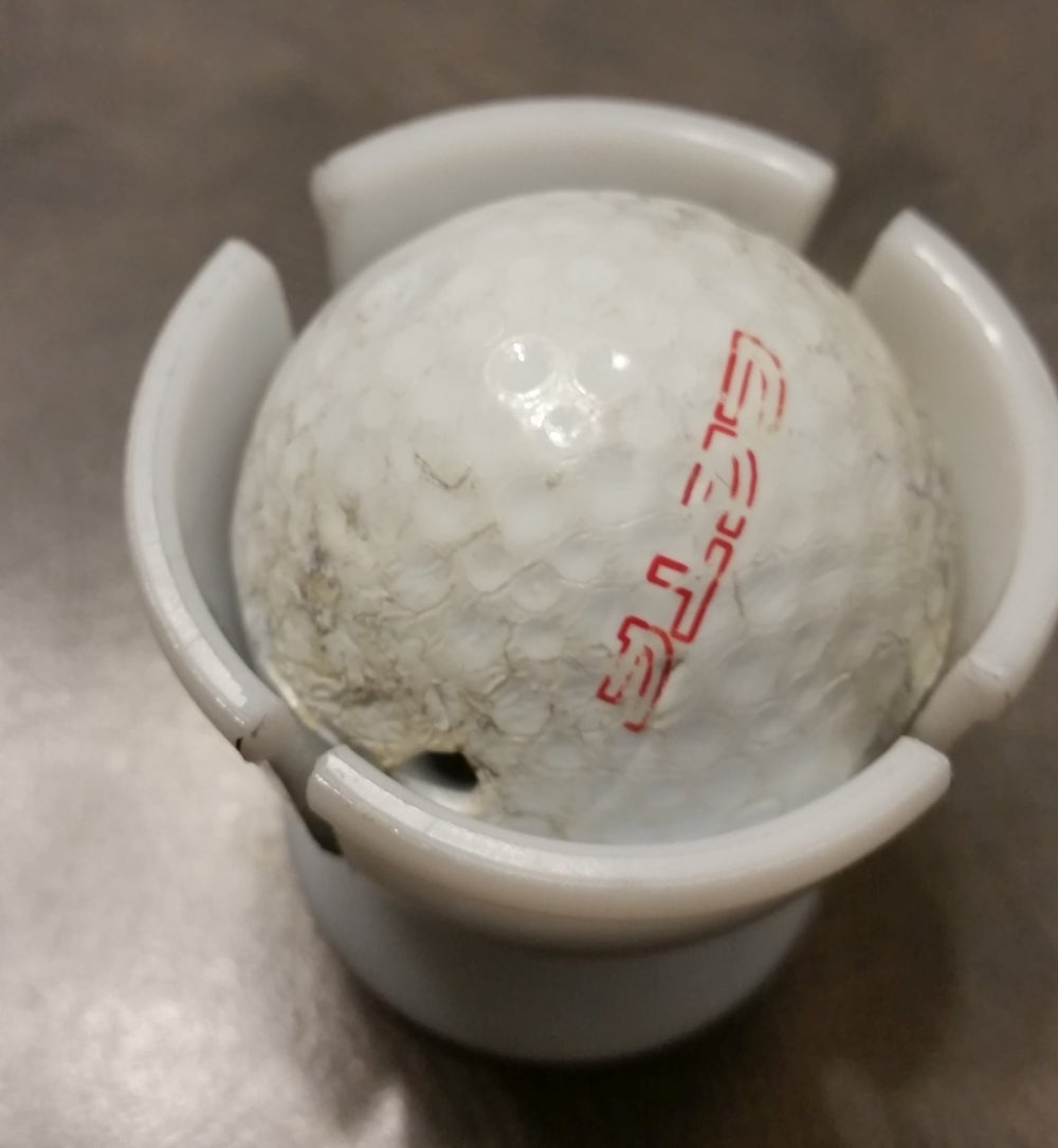

Step 6: Add Elastics and Test

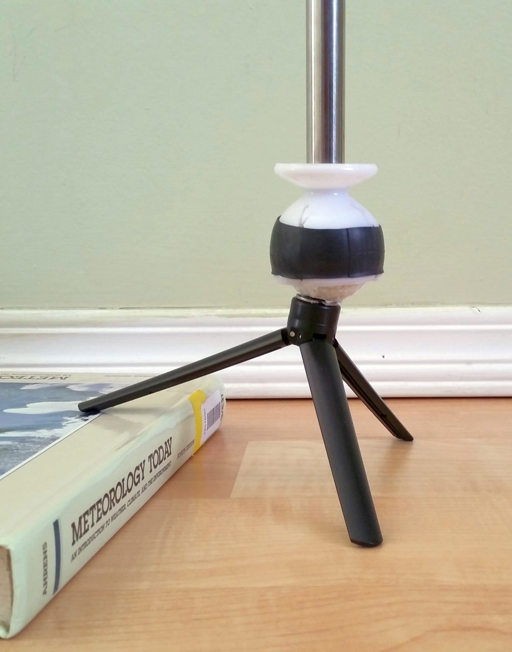

Put the ball into the socket, then wrap an elastic around the socket. If using a rubber band, coil it in thirds or fourths until the ball is tight in the socket.

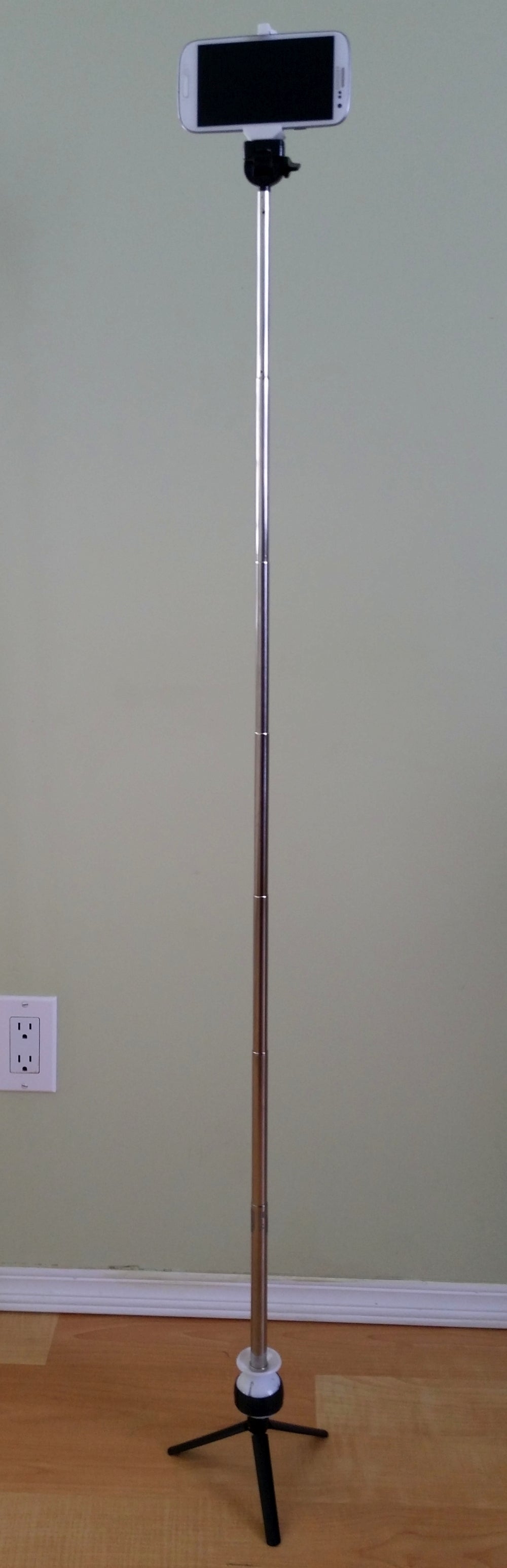

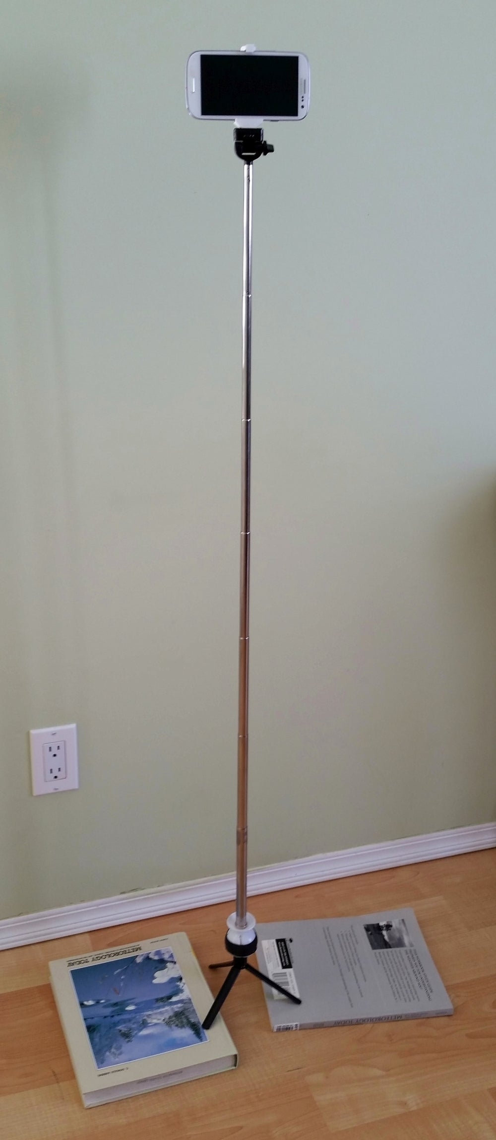

Attach the tripod and selfie stick to the adapter, then place your phone on its holder on the stick. Center the phone on the holder. Set the stick upright on a flat solid surface, and it should be able to stand on its own. If not, add more elastic.
Test the tightness on uneven ground by placing your foot or a small object under one of the tripod legs. With the tripod tilted, nudge the stick back to vertical. If the stick stays upright when you let go, you're done. You can add more elastic for stability. But if the tripod moves when you adjust the stick, it's too tight.

You can use a bubble level to make sure the stick is vertical, but I found that eyeballing it works well enough. You just need to make sure that the camera (or more precisely, the center of mass of the stick plus camera system) stays within and above the magic triangle formed by the ends of the tripod legs. Still, the closer to vertical the stick is, the more stable the setup. The need to be vertical might be more critical with a monopod, which is heavier and longer than a selfie stick. A little tilt, and the center of mass is outside the magic triangle. Lower the camera, maximize the socket tightness, or use a tripod with a wider footprint, for better stability.
Obviously you should use common sense when using the setup. If the ground is too steep, if it's too windy, or if the surface isn't rigid (e.g., covered with tall grass), rethink your placement.
This device works only on light devices like smartphones and action cameras. They have to be balanced on the vertical support, so you can't use this on a real camera whose center of mass shifts as its lens zooms in and out.
