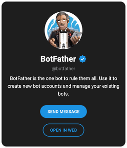

  1. Create a Telegram bot using @botfather (FAQ).
  2. Username: @<NAME>Bot
  3. Disable Allow Groups?
  4. Turn on Group Privacy
  5. The bot Token will be available once the bot is created. Write it down, you'll need it in a later step.
