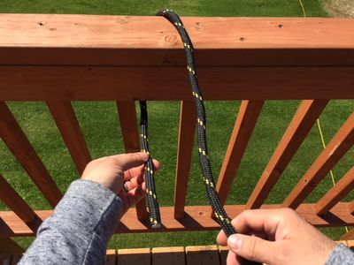

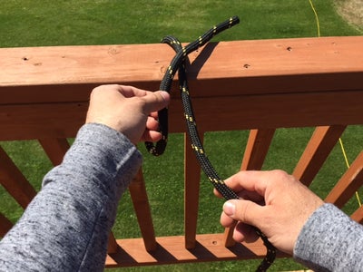

Steps 7 through 10: The Clove Hitch
This knot works best when securing a line that is holding a load for you. Again, it comes apart easy, and is quick.

Step 7: The Clove Hitch
Step 8: Throw the Line Over and Cross Your First Wrap of the Line
Step 9: Bring Your Line Up and Put the Dead End Under Your Crossed Line
Step 10: Pull Tight
Your hitched, to a clove.
