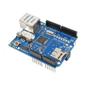

- Shield ethernet W5100
- APP Omniblug IP Public

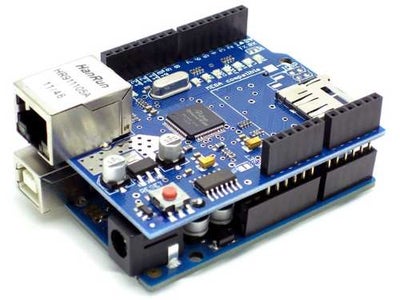

Step 1: Assembly
The assembly of the shield with Arduino is very simple, we must link the two parts, as shown in the images.
Once assembled, we loaded the scket, we can download it here.
We programmed the module Arduino and that's it.
With a network cable Arduino connect to our router.

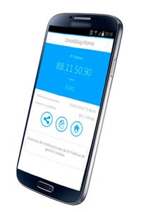

The next step we must do is download the APP Omniblug Home IP of Google Play Store.
Download.
The first step we must do is open the application to set the IP and port of arduino in the adjustments of the application (must match those that we have in the program scket arduino, see you image).
It is important to remember that we must be connected to the local wifi with our mobile to program the module. After setting the ip and port, we go to the Module option and click on the send button configuration.
We waited a few seconds until appear the message that we all went well displayed.
You will shortly receive notification in our mobile with the Public IP from router.
So there you go, we have our public notification system ip configured and ready to go.
