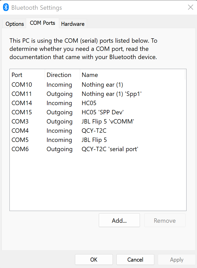

Windows Bluetooth Connection
The HC-05 Modul is password protected, which means we need to connect to it manually first to than be able to get the COM port it is on and be able to connect to it through Python.
For that we go to the Bluetooth Settings in Windows (The Ardunio should be powered on and have the Script on it) and add a new Device, after a few seconds the HC-05 Modul should appear as a device, clicking on it we are asked to enter a password, which by default should be set to "1234", very secure!
After entering the password and having added the new device we can go into "more bluetooth options" and click on the "COM" Tab, you should see the HC modul twice one port is going to be the input and one the output. We are mostly insteresed in the outgoing COM port, not it down we are going to need this one for the Python script!
