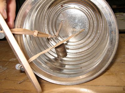

Step 4: Thread Bands
1. Thread bands through holes.
2. Attach weight to the center of low tensioned band.
3. Use nails to secure bands.
- I recommend a hole larger than the 1/8" holes in the photos. It was hard to thread the rubber bands.

Step 6: Secure Weight
1. Connect weight securely to rubber band knot
2. Add tape
2. Add tape
