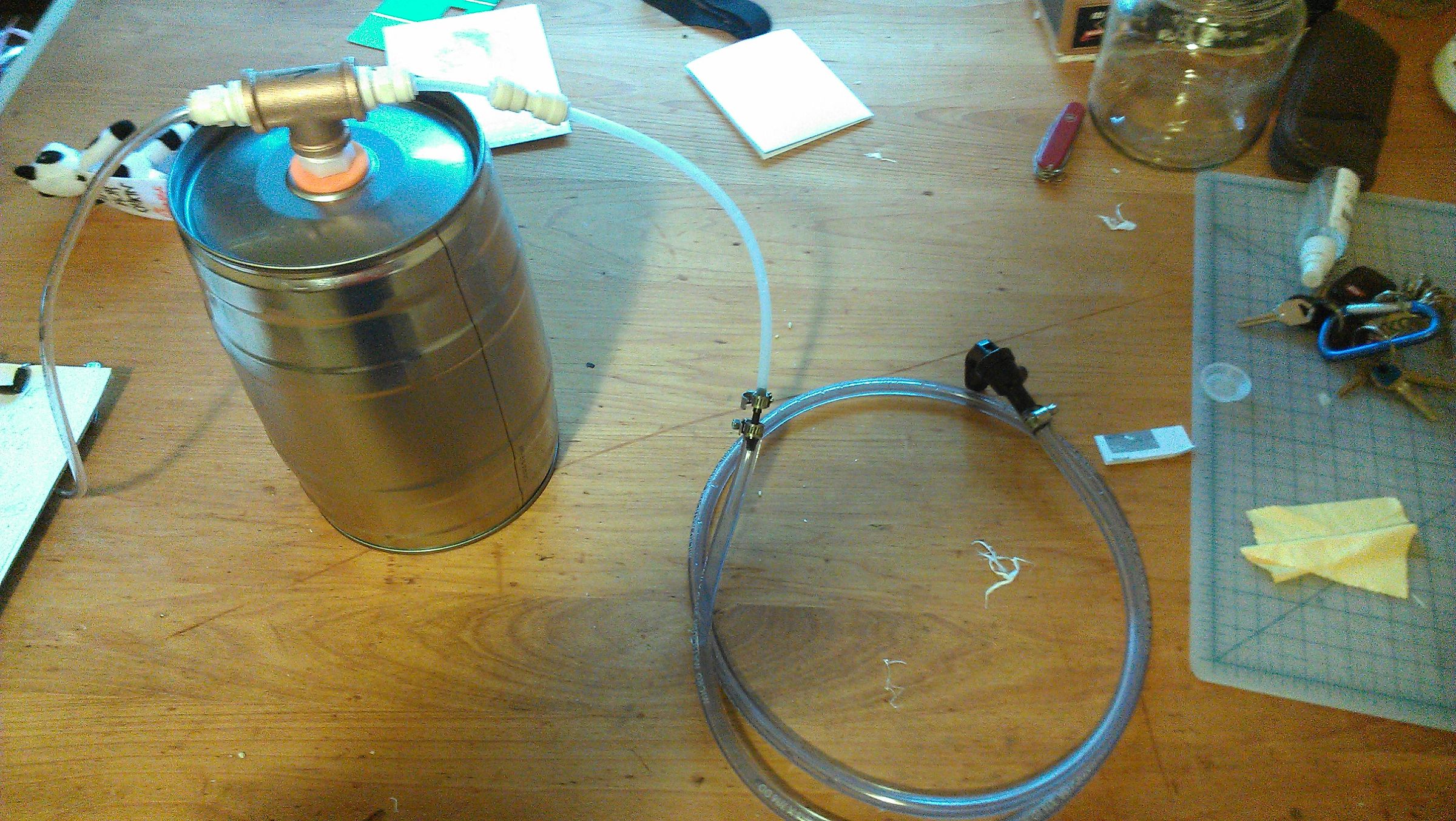

Step 2: Adapt the Beer Line
First we need to build you beer line.
Krups uses a propitiatory tap valve which we need to hi-jack.
On the beertender tap, pull the tube out of the gray piece, It is just held in with some plastic shims.
The beer line that comes in the kit is quite long, and you may be tempted to cut it to size. Don't, the longer it is the better the pour. Also, since the beertender tap is designed to be a one time use piece, I imagine that it will be the first thing to fail so its nice having the coupling there to only replace part of the beer line and not the entire thing.

Step 4: Tap Your Keg
I used the cleaning bottle to run some vinegar and water through the line to clean it.
I did take apart and wrap with Teflon tape all the joints and couplings I could on the tap.
To tap the keg you need to either remove the existing bung, or if the bung allows for it, run the tap through it.
On the Spaten, I had to remove the bung. First I vented the keg (turned the red knob on top), then pulled the red valve and then the rest of the bung. I stuck in one of the included orange reusable bung and put the tap in.
Note the arrow on top of the tap. It points to the beer line. Hook up all the quick connects on the tap. Before you put your CO2 on the regulator, turn it all the way to off. Screw all your adapters into the regulator, if you are using a paintball tank screw all the pieces together and add the tank last. Push the clear line into the regulator, and turn it up to about 15psi.
Now you want to grab a soapy rag and check for leaks. I had a gas leak where my gas line connected to the tap. I had to cut and reseat the line and I was good to go.
