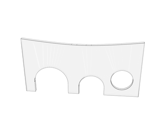

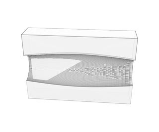

The Kururin Gauge contains all the measurements you need on one handy tool: length, half length, middle diameter and end diameter. No need to have a ruler or keep changing caliper dimensions! The second tool is the Kururin Sanding Jig, which is a cradle to hold the Kururin while you finish the ends using a disc sander. Without it, your Kururin probably won't stand vertical and proud. With it, you'll have perfect ends every time!

Use the Kururin Gauge to mark the length (90mm) of the Kururin.
- The parting tool is used again to make a groove 90mm from the other one.
- A skew chisel (the tool I used) or scraper is used to get the middle diameter (27mm). Don't forget the Kururin Gauge has a cut out for this dimension!

- Check the profile with the Kururin Gauge, if it isn't good, try and fix it.

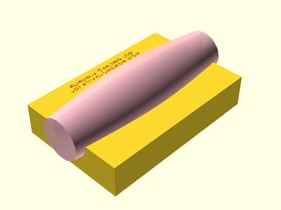

Step 3: Finish the Ends
You could use the parting tool to reduce the diameter of the wood next to the ends but I find this to be a risk strategy because the wood can break and the Kururin will fly off the lathe, probably damaging it. Since you've just got it perfect, you don't want that!
- Use a bandsaw or just a regular saw to remove most of the material at the ends but don't go too close too the ends. I use the Kururin Sanding Jig for this step but it's not essential.
- Make sure the miter fence is perpendicular to the disc sander sandpaper using a set square. If you don't do this then there is no point using the jig I designed for you!
- Hold the Kururin firmly in the Kururin Sanding Jig and place it against the mitre gauge. Gently push it into the disk and get that end perfect.
- Check you have done a good job by putting the Kururin on a flat surface and rotate it on its axis. If it wobbles then things haven't gone well. If it stand vertical the whole way round, well done! All the hard work is done.

Step 5: Kururin Gauge
The Kururin Gauge was designed using Inkscape and OpenSCAD. I cut it out using a laser cutter and acrylic but I have included an STL file for 3D printers. At a pinch you could print it on paper, stick it to card-stock and cut it out. The files are attached to this step but if you want to edit them, visit my website for all the design files.
Step 6: Kururin Sanding Jig
The Kururin Sanding Jig was designed with Inkscape and OpenSCAD. I have attached the STL file to this step but if you want to edit it you can visit my website for all the design files.
