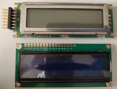

Step 1: Seiko M1632 Vs New HD44780 Display
The factory display Kurzweil installed both in K1000/1200 series sinthesizers was a Seiko M1632 display.
This display is based on an Hitachi controller (ASIC): the HD44780. This is still used today on those displays commonly used for DIY project.
The main differences between the Seiko EL backlight display and modern LED backlight display based on HD44780 are:
- Pinout: the two displays have a different pin position and pinout (signals are the same however)
- Backlight: the old backlight was electro luminescent (EL), while the new one is LED. This asks for contrast control and a different voltage.
- Phisical: the new display has different dimensions
In the following we will find a solution for every single difference.

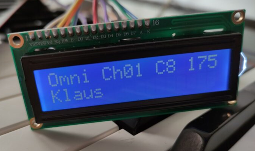

To help in this part of the project, I have realized a PCB with screen printed pin positions. Simply solder cables straight from the new display pins to the corresponding PCB pins and you are good to go.
The board also hosts the contrast voltage divider the LED backlight asks for.

Step 3: New Display Physical Modifications
As we have seen, the old, factory, Seiko display and the new one are physically different.
Installing it in a K1000 keyboard or K1000 rack asks for cuts on the new display board, at different positions. In particular:
- K1000 keyboard: cut the bottom part of the display PCB
- K1000 rack: cut the bottom part of the display PCB and both sides
See the pic for a graphical representation. The orange parts must be drilleld away.
I used a mini driller with a little grinder on top for this operation.
In case of the keyboard version, you will additionally need to drill three mounting holes, or glue the display onto the original synthetizer display board.
In case of the rack version, the only method I could think of to install the new display was the use of hot glue and some 6 mm spacers. It works well and don't ask for irreversible modifications to your valuable instrument.
