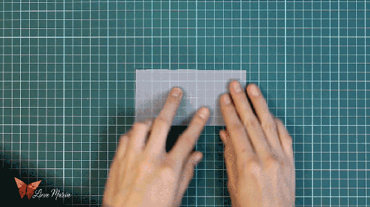

Step 2: Papers
For this figure, you need 30 pieces of paper that have a 2:1 ratio.
I used a parchment paper block, each paper was 24.8 x 35 cm, I folded this in half (as the second image shows) and then I folded triangles to get perfect squares that I then folded in half and cut. This gave me 12.4 x 6.2 cm papers.
In case you want to use the 3D modeling that I upload in this instructable for the 3d printed parts, it is necessary that your rectangles are the same size as mine (12.4 x 6.2 cm)

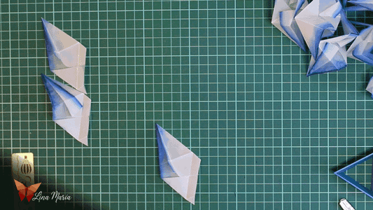

Step 3: Module
Step 3 (this one) through step 18 shows how to create the basic module for this figure.
It is necessary to repeat these steps with the 30 papers.

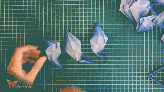

Step 19:
Unfold the papers, paint the edges with a watercolor pencil as shown in the images and create a gradient with water.
Step 20:
When they have dried, fold them again

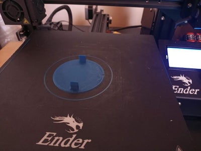

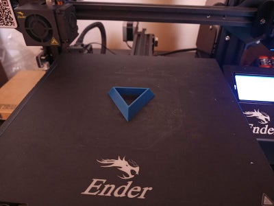

Step 21: Lamp Base
I created the files in Inventor, saved them as stl files, and printed them with Cura and an ender 3 pro printer.
(You may find the videos of the modeling process here: https://youtu.be/1kB0O8TLwfQ - https://youtu.be/k7rYmI79OqQ)
Step 22: 3D Print
Step 23:

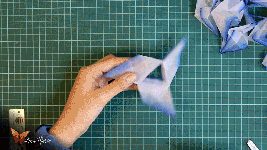

Step 27: Assembling the Modules
To show you how the modules are assembled, I decided to make a video of how I put mine together.
(To join them I usually imagine triangles each time I join 3 papers (creating a point - tetrahedron) and then I think that there should always be 5 triangles joined)
